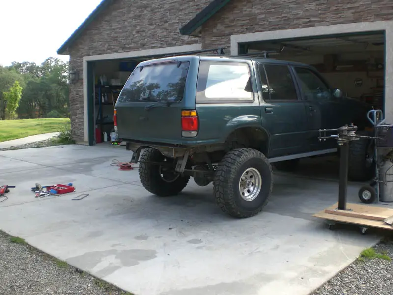

Only a slight amount of work got done this weekend. But hey, that's two weekends in a row. That's more than I've worked on this thing all year. :p: :thumbsup:
I'm waiting for my Pro Tools notcher to show up (probably tomorrow) before I do anymore tube work. But I did some cutting in preparation for a new bumper. :cool:

Your Explorer doesnt have single a dent! Get it to the trails quick!
EDIT - Hi Danny.
It has two dents! One from trying to get a TV into the back seat.. another from a trash can. :) :p:

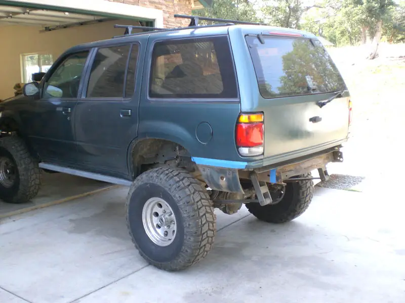

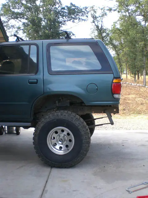

So here is the concept I'm working on:
If you run pieces down the sides make sure you tie them into the frame. I see you trimed the spare tire hump, I did that to and was amazed of how much it weakend the rear frame.:( Once the bumper had the side pieces tied to the frame, it was stronger then ever though;)
I tried to cut off as little as possible. Did you cut more, or about the same, as what I did?
That's basically my plan. The top of the bumper will wrap around the side. It's going to look pretty similar to Josh S.'s. Just larger tube and flush with the hatch.

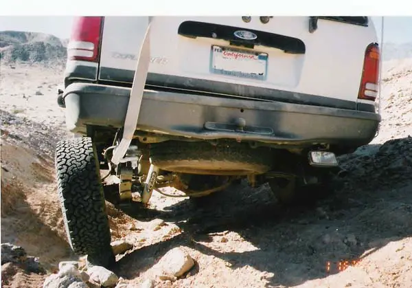

I cut less. and you have to leave a gap above the rear bumper. at least a inch or more. The rear frame flexes so much that the bumper will crush your corners. Bkenndy had this happen. Some where there is a picture of my truck from calico I think that shows how much the frame flexes. I'll see if I can find it.
Yeah get a pic! But I meant flush front to back. So it won't have the diamond plate step (which isn't in that particular pic) that Josh has. Then I'll mount some tow hooks on the outside of the frame rails and call it good.
Couldn't find the pic, might have it in my private collection;) But I'm telling you basicly the pic is of one rear tire on a rock, and you can see the rear bumper is touching the body on one side and there is large gap on the other side.
Wait: Found one...not the pic I was looking for but you get what I'm talking about. With more flex, it's more dramatic.
I pushed both corners up on the navajo once when I dropped off a ledge.. So it's not just the frame flex, it's the body bushings also.
