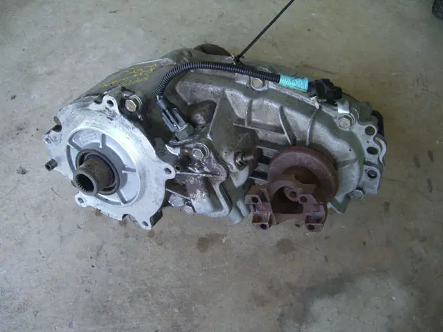

Bought a spare manual 1354 case today for a whopping $92. Can't beat that. :salute:
92$ you lucky dog :D

There's another one at the yard we were at. You just have to pull it. The one I picked up was in the tcase bin. But they should be the same price. :thumbsup:
I think im gonna have to go pull that ugly duck out....good lookin out!:thumbsup:

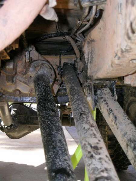

You inquired about clearance of the 1354, the chassis, and upper link :
This is at full droop right before I removed the shocks. The fuel lines run on top of the chassis, they used to run on the side of it.

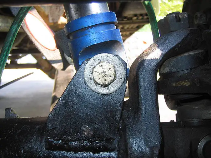

Another reference pic for yewww

I dont understand why you want to buy mounts when you can cut them in minutes, MINUTES!!! with that plasma cutter.
I'm still using stupid cut-off wheels on a grinder - how crude.
I didn't say I was going to buy them.
I was just working from that design. I have my cardboard cut out and I'm gonna blast some out tonight. I just wanted your professional opinion on them first. :salute:
So I think now I'm going to combine yours with that design and make something bling.
You cut and turned, didn't you? Maybe I should do that before I do anything else. :eek:

gotcha mate!
Yeah you gotta cut and turn first -- its time consuming so just take it easy, the inner knuckle will give in eventually.
