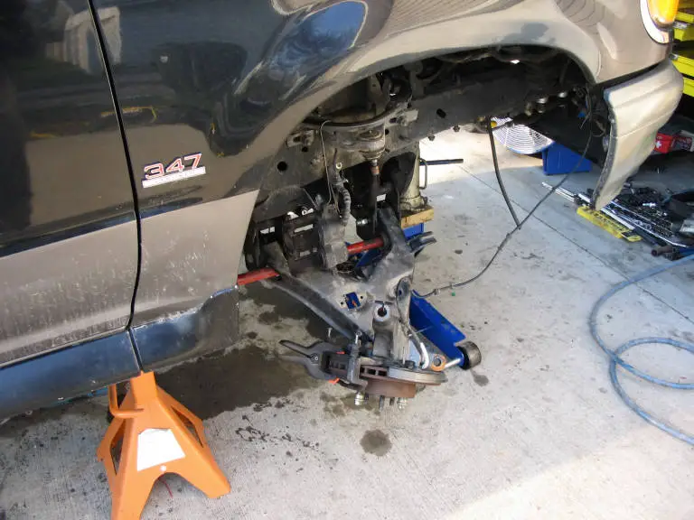

I'm bypassing the dumb dash gauge and messages. I turned up an electric oil pump I bought countless years ago. It's a Moroso(#4030) pre-lubing pump, with a cute little four wire control box, and I've misplaced the instructions. I'm sure it was for a turbo application, but I can deal with it. I have a low pressure sensor on my SOHC to turn on my headlights. It's a NOs sensor to disable a fuel pump. I'll use another like it to trigger the extra oil pump. When I turn on the key, the pump will build pressure. When the engine starts, oil pressure will turn off the pump. I just need to wire in a light to show pump activity, and add another oil pressure gauge. Much to do,
