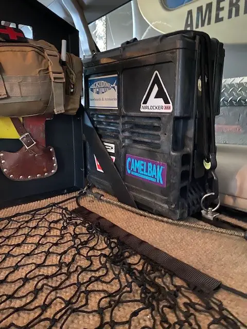

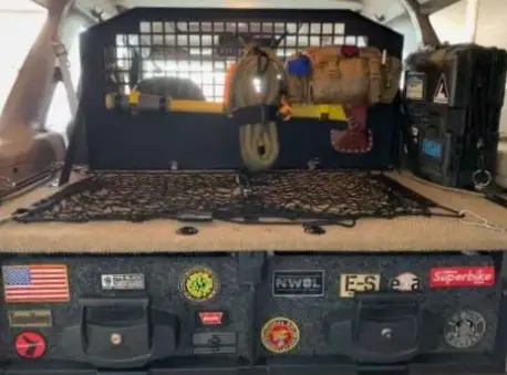

Always looking for more storage - - as it seems a lot of the "nice-to-have" stuff takes up more and more room. The drawer system I've had for years is a nice piece of kit, and although the drawers aren't that deep, I've found a way to use most of the void space behind the rear seat and along the sides to stash gear for the trail.
Had an opportunity to grab a "headache" guard and thought it'd be a good place to hang some of the more commonly used items (with the added benefit of keeping anything in the cargo area from impacting the nugget in a crash/trail mishap). . . Since the deck top of the drawer system is wood covered with carpet, it was a pretty simple install.
Hooked to the rack is an axe, first aid kit, and kinetic rope with soft shackles.
The bracket support for the rack, coupled with the track O-rings provides stability for a NATO plastic ammo box I've been lugging around for the last 30 years. . . Great place to store extra fluids in a totally self-contained box, without concerns about leakage, spillage, etc.
Minor stuff, I'll admit - - but getting excited for Moab (45 days!) 2023.
