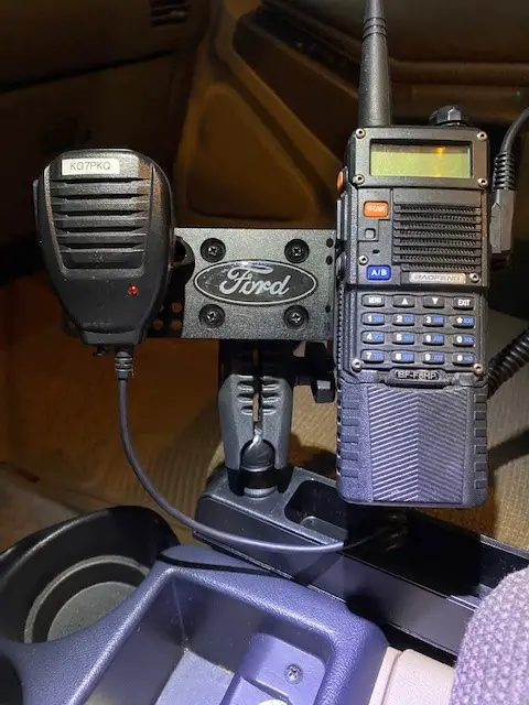

Finally got off my butt and took the Ham Technician's test - - almost all the guys I wheel with now are HAMs, so made sense to get the license. Still shopping for a radio, plan on starting with an HT, then upgrade in time to a fixed mount in the rig. . .
Did purchase a simple handheld vehicle mount (radio a loaner from Kevin), just so its one less thing lying on the seat, or the floor, etc.
Good thing is that whatever HT I end up with I'll be able to transfer from vehicle to vehicle after I hard mount a Ham in the rig. . . Mount is "wedge" style, friction-mount between the seat cushion and console.

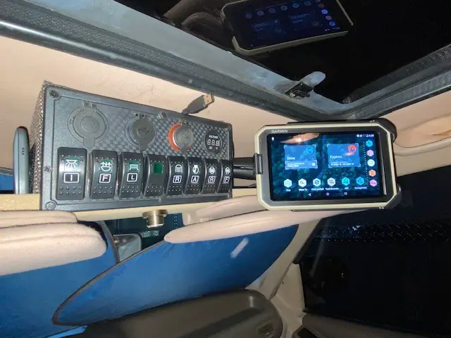

"And then there was one . . ."
. . . switch available.
Switches Left to Right:
I = Interior Dome Light (below visor)
F = Fog Lights (Warn) on Front Bumper
L = LEDs on Front Bumper
Blank
R = Rear Back-Up Lights on Rear Bumper
A = ARB Compressor
R = Rear Air Locker
F = Front Air Locker

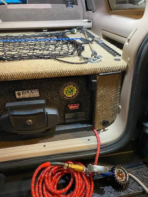

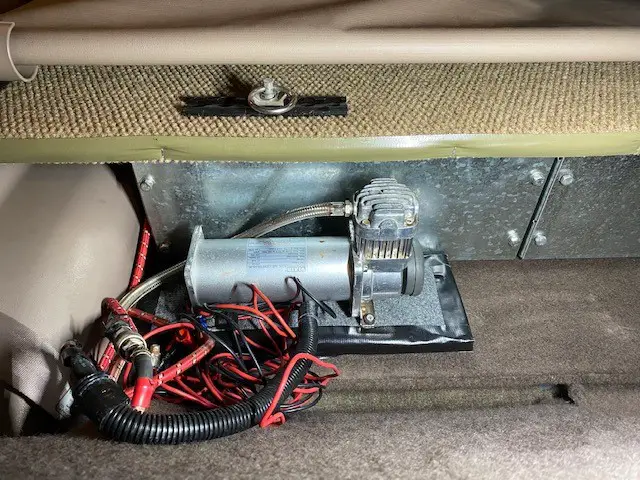

ViaAir Reinstall. . .
Snugged in behind the rear passenger seat, in front of the Outback drawer system. No worries, the mongosso wire ball gets sorted. . .

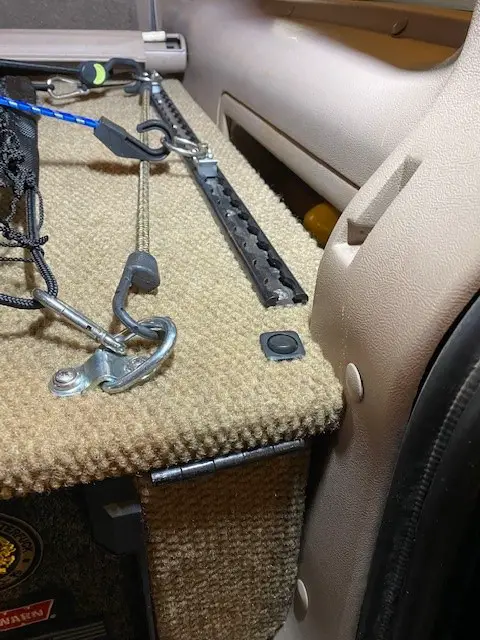

Switch in the cargo area:
Hose coils up and is bagged into the storage bin under the switch:

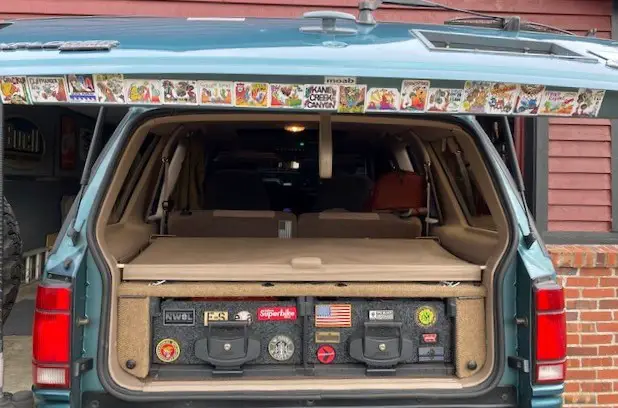

All tucked away - - stickers on the bottom edge of the hatch are trails that I've and (major components of) this rig have run in Moab - - last year included Kane Creek, Moab Rim, and Top of the World . . .
Stickers Left to Right: Chicken Corners (Wife's favorite), Cliffhanger, Dome Plateau, Fins & Things, Flat Iron Mesa, Gold Bar Rim, Golden Spike, Hells' Revenge, Hey Joe Canyon, Kane Creek Canyon, Metal Masher, Moab Rim, Poison Spider, Porcupine Rim, Rose Garden Hill, Seven Mile Rim, Steel Bender, Strike Ravine, and Top of the World)

Love the stickers!! Good location for them
Do you have an air tank plumbed into the compressor? The cheapo harbor freight compressor I run looks like a knock off of the vair (of course right)
Well done as usual!
Paul
August 18, 1999
1,203
442
Grit City, Washington
'94 “Sport”
Initially, yes - - I did have an air tank circa 2010, but removed it. Can't say it was really needed, don't have air tools and likely not needed now-days on the trails with the ever-improving handheld battery technology of power tools. When I had the air tank, it was mounted in the spare tire void, but that space is now home to the roto-pax fuel cell.
So, for my use, the ViAir is just there to top off the tires after a run - - and the unit I have is continuous duty rated, so it's up to the task.
Lastly, I try to be really diligent on all the "extras" I add to this rig. . . and by that I mean to balance what I "need" for the type of trails that I run versus all the doo-dads and gizmos that I could bring along, just because something might be the newest "bright and shiny thing" in the four-wheeling community. I need an air compressor and have a portable one - -but that takes up room in my drawer system, so by hardwiring this one - - that I'll need virtually anytime I go four-wheeling, I get a little more space in the drawers . . .
. . . for the next "bright and shiny thing" I can't live without. . . Wait, what?
I always try to weigh necessity vs nice to have vs weight for my rig. I consider a compressor a necessity. I'll admit, mine is packed with nice to have in the trail stuff.

The FJ and the bii have compressors hard wired in and no air tank, mostly just for filling tires…. So handy! I also added one of the cheapo hf units to our Polaris because there is always an atv or something back here with a low tire. When the kids hit the river in the summer it’s handy for filling tubes also. I agree with you I have a dewalt 20v impact that will rip 1350ft lbs…. I ditched the air lines and pneumatic tools in the shop too,
Much better especially for us since the shop is off grid and whole place is battery powered. Keep it simple!!
Agreed. . . I'm all for self-sufficiency, realizing you can't plan for every contingency, but want to have the stuff required to "help myself" off the trail.

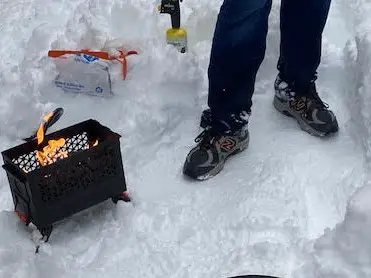

And now on to "Bright & Shiny". . .

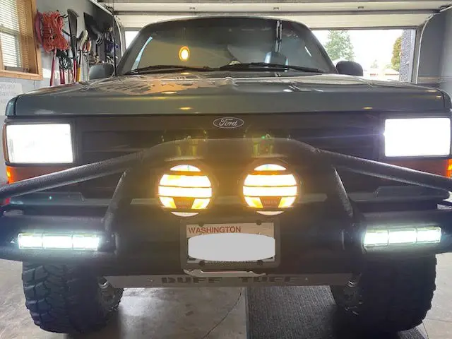

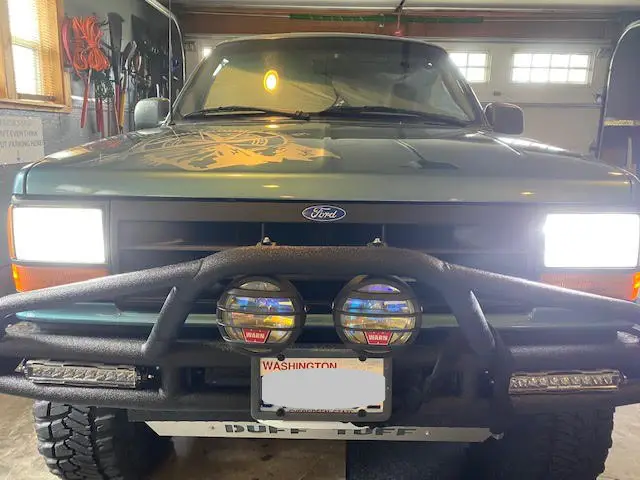

Last bit of lighting/wiring upgrades - - at least for now. . . Realized just how limited the OEM style headlight bulbs are, so swapped them out with LED replacements. Had to modify the bezel "connector rings" to accommodate the LED housing, but overall very satisfied with results. No "before" pictures , but here you go:
Hardly a "light show", but should be good enough. . .

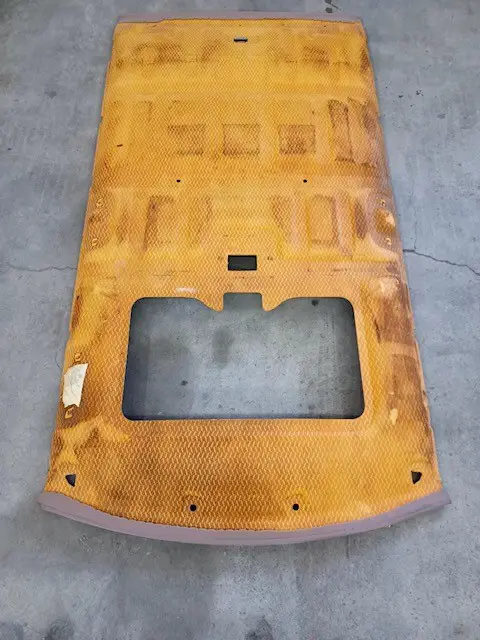

Something going on . . .
Panel is very good shape for 28 years, but a few rips and separations in the headliner warranted a re-do. . .

going suede? or starry?:cool: or new switch mount location?
Paul
Mine is trashed. With the cage in place it has to stay that way :(
OEM-ish, just regular beige colored headliner material. Have seen a few "Starry Night" headliner projects, pretty neat stuff, but not really my style. Perfectly satisfied with the switch panel on the visor shelf as currently configured. . .
Yep, re-did the headliner in the '91 before that cage was installed, doubtful I'll go the cage route on this one, but the rig is just so damn clean looking, want to keep it like it's just a few years old, not nearing 30.

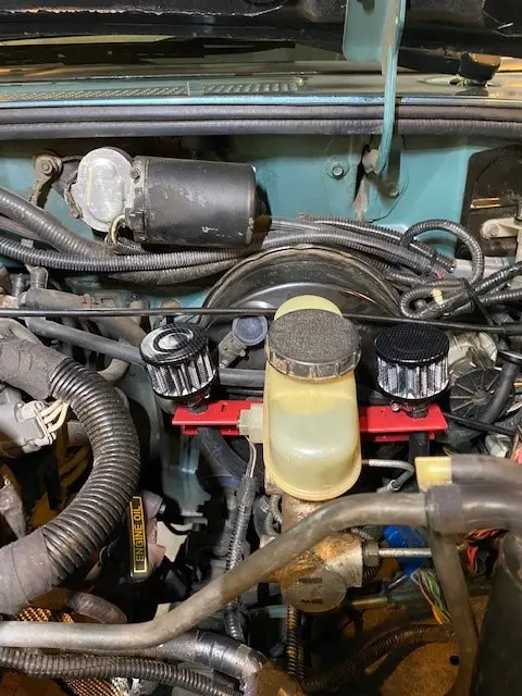

Still waiting for summer up here, but no complaints. . . Spent a little time in the Man Cave working on some minor projects - - just busy work, but something I wanted to knock out.
Breather filters:
Left side for the Atlas II transfer case, right side for the front differential.
Rear differential, stuck in the void behind the driver's side tail light, stole the location idea from Brian1. . .
