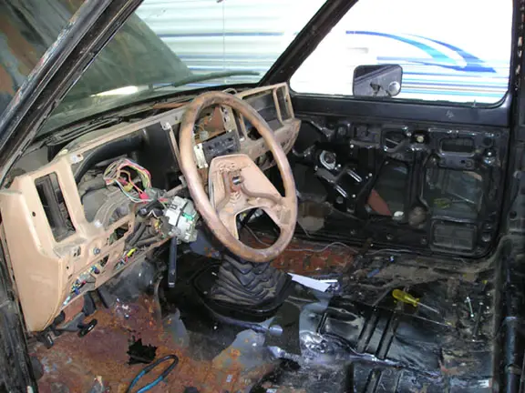

Hope that rust isn't through... If it's surface I would suggest some naval jelly and a little primer / paint ... so much hard work going into this, would be a shame to see the cab rust through!
Well did some work on the little moster today. Dove into the interior, and ripped it all out to start the painting prosess. The Interior will be Black and Grey.
