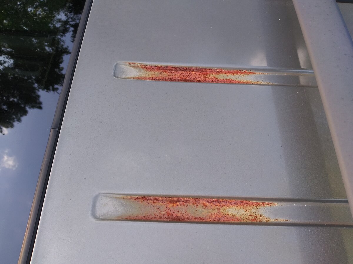

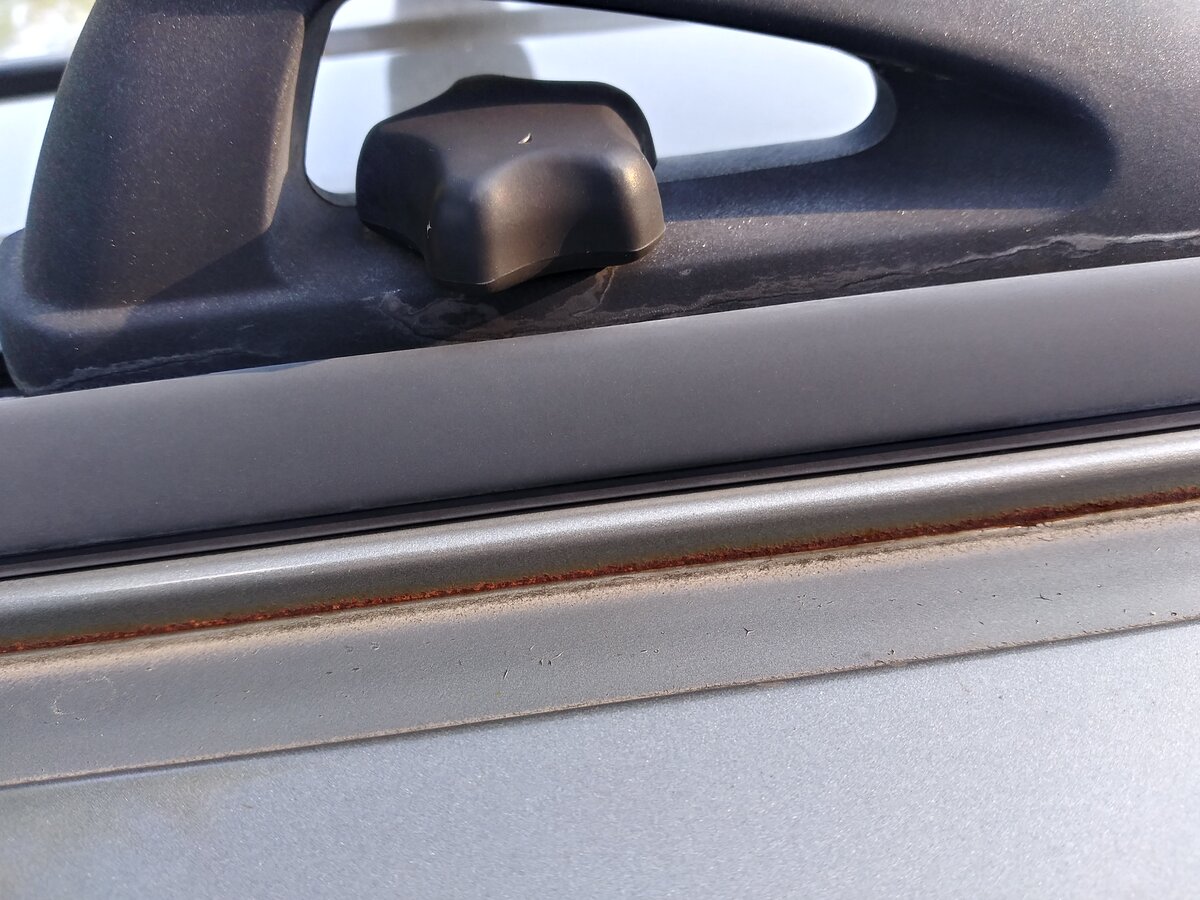

Got a quote on painting Hazey's roof, after I deal with this rust. There's not much rust to see, but I tend to freak out when I see it.
Pal at the body shop recommended me to grab some OSPHO and spread it over all the rusted areas, wait 24 hours for it to dry (it turns black), and then paint it. A workmate of my brother's does touch-up paint, and quoted me $40 for it. I can't complain about that price!
Rust in the roof grooves behind the sun roof. Kill it before it spreads to the rails!
Tiny strip of rust at the bottom of rain rails, on both sides, all the way from front to back. This is going to require very careful attention when applying OSPHO, because that stuff is very thin.

seems like the roof channels always do that, its the first spot.Got a quote on painting Hazey's roof, after I deal with this rust. There's not much rust to see, but I tend to freak out when I see it.

That first picture is rust that is easy to fix, it's shallow and it should be sanded to bare metal, and then sprayed with epoxy primer, and paint.
That 2nd picture shows rust which might be a body seam, which if it is, that is serious and may not be fixable depending on how deep it is.
Any rust not in between body panels, in Seams, should be minor trouble to fix and paint over. But rust in seams is permanent in general, because you cannot access all of it, so some survives whatever you do to it. The OSPHO chemical is a great rust converting product, most good body men use it. But it's still a surface rust product, deep rust and that inside seams is an entirely different problem.
I'd mask off that line of rust and go at it with some sand paper to see how deep that line is, if it's a seam, that's a big deal.

@CDW6212R Yeah, I've been sorta freaking out about rust recently because it's very humid and salty around this area. I'm trying to knock it all out before it gets past the surface. Waiting for my OSPHO to arrive and then a day off to roll around before I can really judge the rust on the edges; there's no point sanding it early because it'll be right back in a day.
As far as the rust in the grooves, thank God I got the truck before that spread to the black rails, because after it got there, I'd have to drill the rivets, and that would have probably broken the sale. I hate rust.

If you think you have a rust prone area or car, check the bottom edge of the doors, and the hatch. There is a body seam there on all of those, if the seal of that seam is broken and air/water gets to it, there will be rust there, which again is between sheet metal(permanent).

Got Hazey's roof touched up to day. Some of the OSPHO dripped or ran, discoloring the paint around the rusted areas, but whatever, I'll take any color rather than rust. It does NOT look pretty, but it'll give it at least a few more years before I've got to worry about it.
