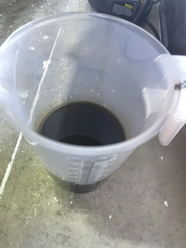

Just changed the fluid on my new PTU, the latest part for Sport/Platinum/EcoBoost PIU models DG1Z-7251-F. This is what it looks like after only 16,000mi!
FYI, I used the vent tube method described in this video and got about 15oz of fluid out. Replaced with AMSOIL Severe Gear.

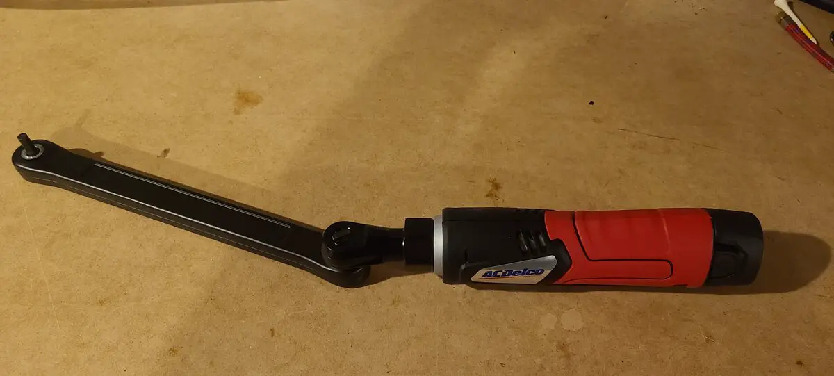

Swapped out the vent hose and changed my PTU fluid this past week. What an ungodly pain in the ass it was getting that drain plug off and back on with a 1/4" ratchet. Next time around, I'll be much better prepared. Got myself a battery ratchet with a ratchet wrench extender. I'm almost looking forward to the next PTU fluid change now :cool:
