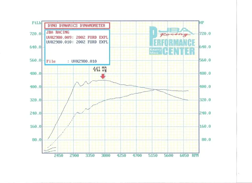

4th gear dyno pulls I guess were fine, but on the street is another story.
Here's a nicer torque curve, at Don's request. This was done on the same day. 400 TQ at 2,900 as opposed to 240 TQ on the pull that broke 400whp.
I'm impressed with what you've done with the M90. I'm glad you made your goal - I have no idea what that feels like cuss I set them too high.
so baddass !!!!!! those numbers are crazy !!!
how much more boost your X capable of handling ??? you said those numbers are " only at 9psi "...

Well this was a pretty high expectation as its never been done before, and its been tried by the best, including AED.
Not even on a 5speed Mustang! So to pull it off with all my handicaps from my drive train loss was not easy :)
The current world record that I know of with an M90 was done with an NSX at 490whp. So thats my next goal, to be the M90 record holder.

Yeah I feel it still has a lot more. I'm switching over to a 85mm TB and modifying my intake inlet, going long tubes and 3'' exhaust. These mods should put me at about 430ish at maybe 7-8psi. Once all that's in line im turning up the wick on the SC another 6,000 RPM's and going 10rib. That pulley combo should put my dial at about 12-13psi and should be enough to cross over 500+whp.
Then im going Trick Flow heads ported from Fox Lake, Modular Performance 324ci (big bore/stroked), aluminum driveshaft, race wheels and tires and another 4,000 blower RPM's. Considering the better flow ill have from the new motor I should see about 14psi on my gauge and looking to bust 600+whp on this M90. Hows that for some high expectations? ;)
So my ultimate goal is to blow all the records out of the water. Then maybe make the switch over to the Tork Tech TVS.
