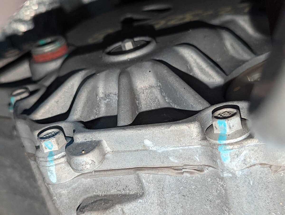

Great post here. I am trying to figure this out on my 2011 4WD explorer. Can someone confirm I've got the right spot? It looks a little different than some of the other pics and I can't seem to locate the vent hose from the top. Is the threaded screw with red thread lock the fill plug for the PTU?
The vent hose is up top you really can't see it underneath. Its short with a black vent cap on top.
That is your fill plug but I don't see the drain plug in that pic
I'm thinking there is no drain plug on this 2011. :(
I can't even see the vent hose/cap from the top engine compartment but I'll look again.
Yours likely does not have a drain plug.
Years ago I had a Ford Freestyle that had a PTU with no drain plug.
I drilled and tapped a hole in the same blank boss you can see next to the left side hex bolt in your pic.
It was surprisingly easy, because the thick oil draining out helped the tap cut threads and pushed any chips out as it drained. My hands were a bit messy during the process however.
It certainly made changing the fluid much easier after that.
Not sure if you are willing to go down that path or not, but wanted to throw it out there as an option.
Thanks but I think that's a little bit above my pay grade. :)

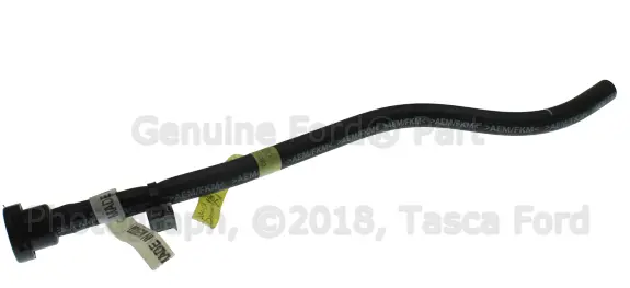

It took me 5 hours to do the work. At least 2 were spent trying to reach the tube on the top, add an extender, and get the top filter off. I couldn't get the new tube onto the old tube with the metal top until I went under and reached up. I lost the filter/vent cap in the engine somewhere.
There's no way to reach it. I had to lay across the engine and use a step stool. I think if you could remove that plastic cover below the windshield wipers it would be more reachable.
But now it should be easy for me to refill the next time.
Genuine Ford Valve Assembly Vent DB5Z-7034-C
