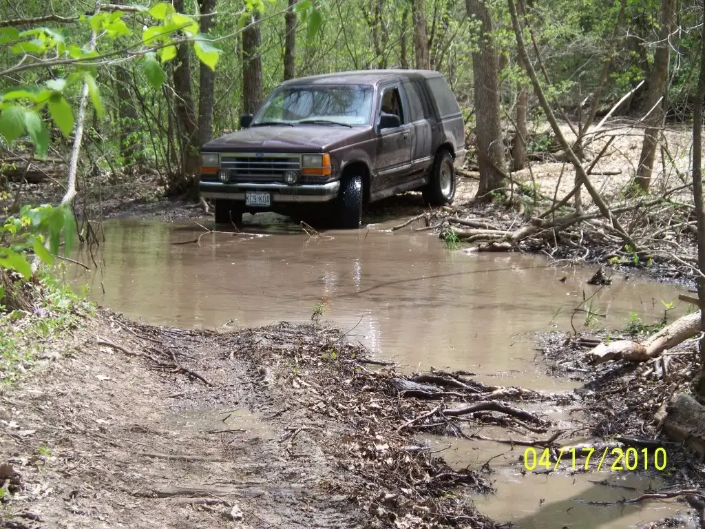

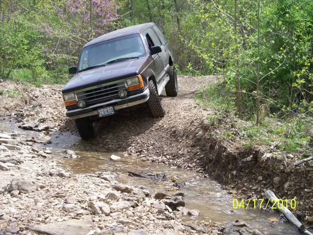

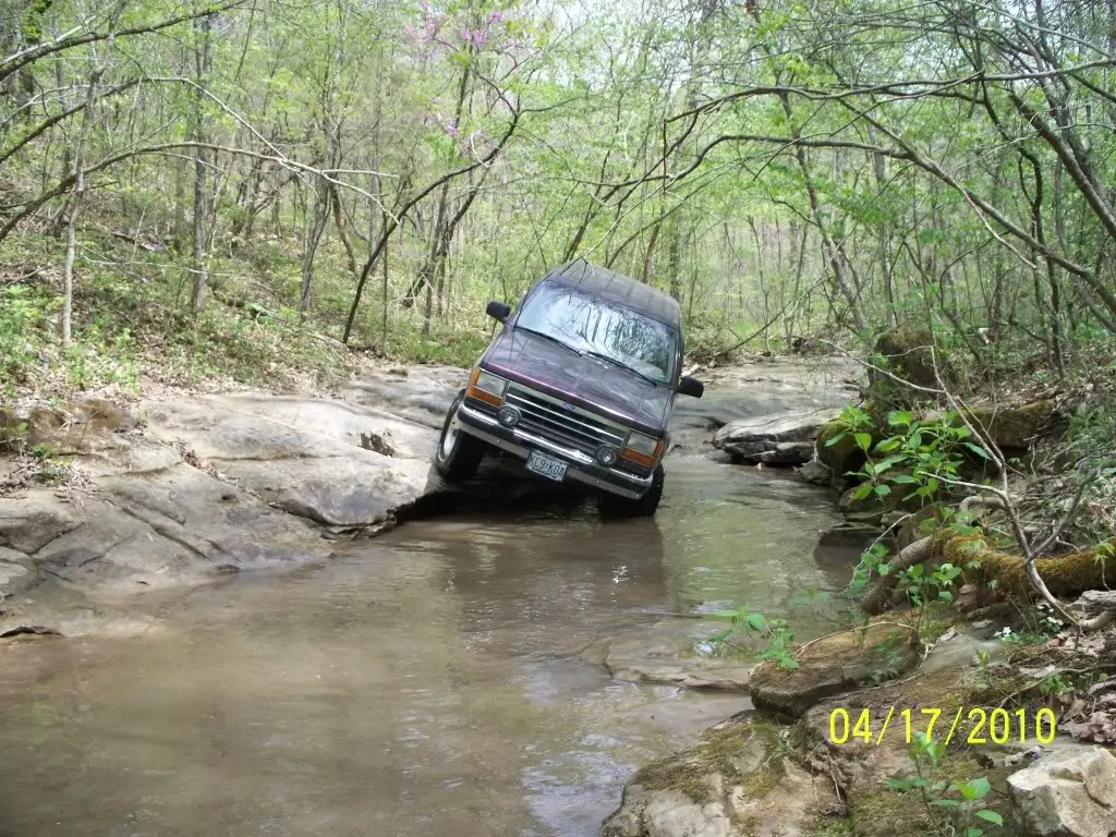

Long way since these days:
I think once it does get a little further setup your gonna love it and i can almost see u driving it more than 95 or at least at Smorr, A cut and turn would be cool with longarms, fairly cheap when i do my buddies I make little Jig so next set easier
Man these photos are making me drool about the good times at Smorr
