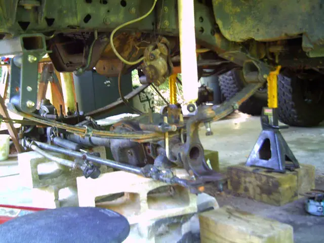

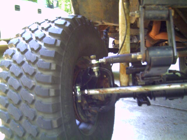

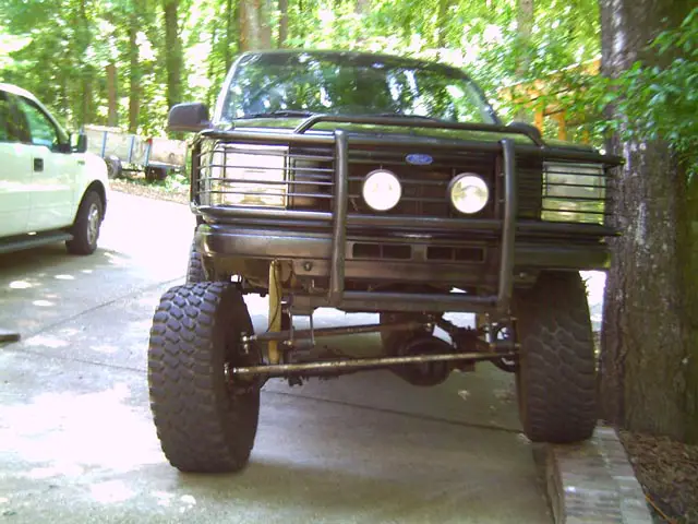

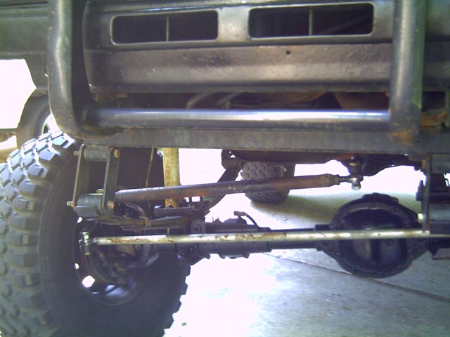

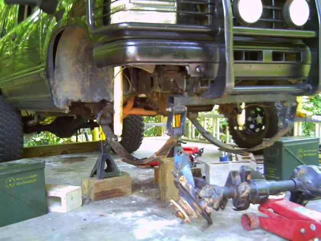

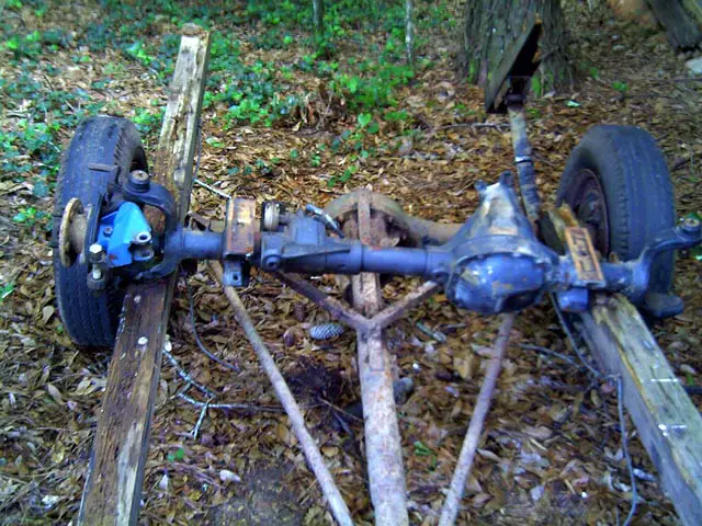

Got the crossover steering in, along with the axle that it came on. The drag link is 1.5" DOM with heims and the tie rod is 1" DOM with heims. The bracket is custom built by BTF out 1/4" plate, and bolts to the spindle. We had to drill out the pitman arm and opposite spindle to accept the bolts for the heims. The new axle has 4.10's and welded spiders in it, which I'll probably swap later on for a 4.56's and a LS. The new steering turned out great. The caster is correct, no bump steer, and it handles beautifully.
The new axle waiting to go in.
We had to take the driver side spindle off the old to put on the new.
Old axle out.
New axle in.
A little driveway flex.
