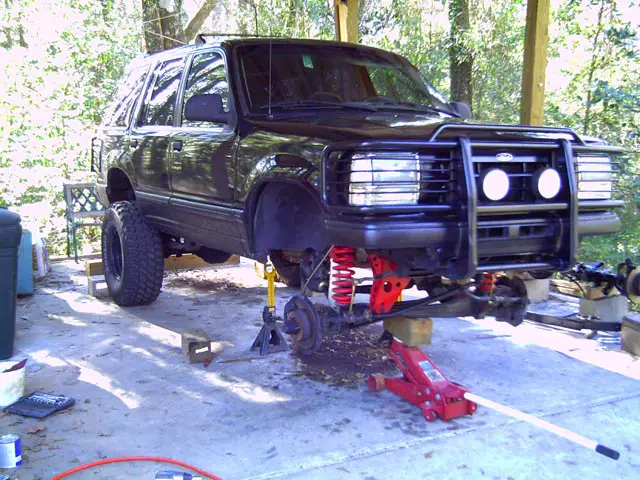

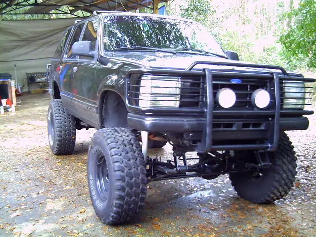

My name's Josh and I live in Dothan, Alabama. I've owned the truck since November, 2003. It's a 1992 Ford Explorer XLT 2WD. I started with basic upgrades and modifications like new paint, clear corners, tires, and wheels. It then turned into a constant work in progress resulting in what it is now.
It's curent state:

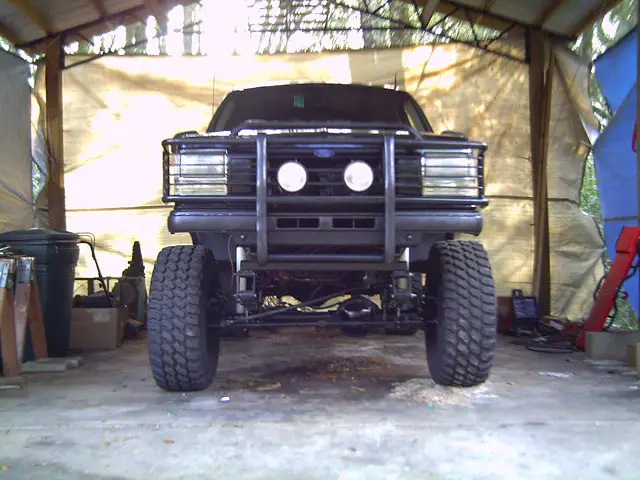

Suspension:
Front -
Custom SAS with HP Dana 30 from a Jeep YJ set up for spring over axle
BTF YJ SOA perches
Pro Comp 2.5" lifted YJ springs
BTF shackles
Warrior spring and shackle hangers
Custom hanger mounts
F-250 shock towers
Rancho RS5000's
Rough Country drop pitman arm
BTF crossover steering bracket with DOM links and heim joints
2" Slanted Body Lift
Rear -
Spring over axle with weld on perches
Warrior shackles
2" Tapered Blocks
Pro Comp ES3000 shocks on swaybar brackets
Homemade swaybar extensions
Relocated brake line with custom bracket
Drivetrain:
4wd transmission swap with electric transfer case that is now manual
KKM open element filter
Flowmaster Cat-back with Original 40 Series swapped in
Single Magnaflow high flow cat
Summit Manual Cutout after Y pipe
EGR delete
Motive 4.56 gears w/ Mobil 1 synthetic gear lube
Powertrax No-Slip locker
Skyjacker SS brake lines

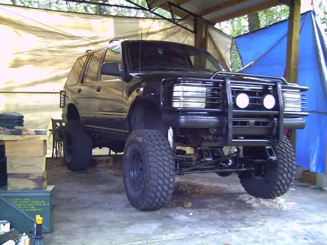

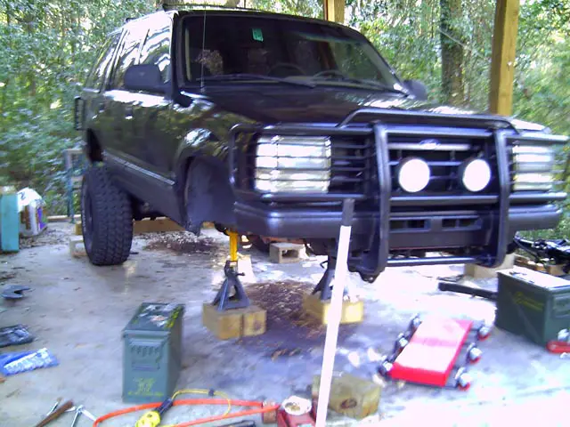

What it was:
Then...
Then...
Then...
