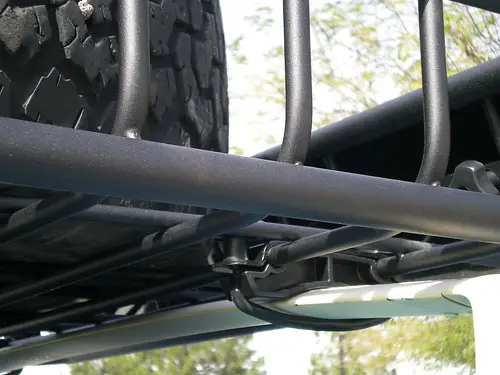

Here is how the coleman rack mounts to the factory cross bars.
just to get your bearings.. pic of basket on truck..
