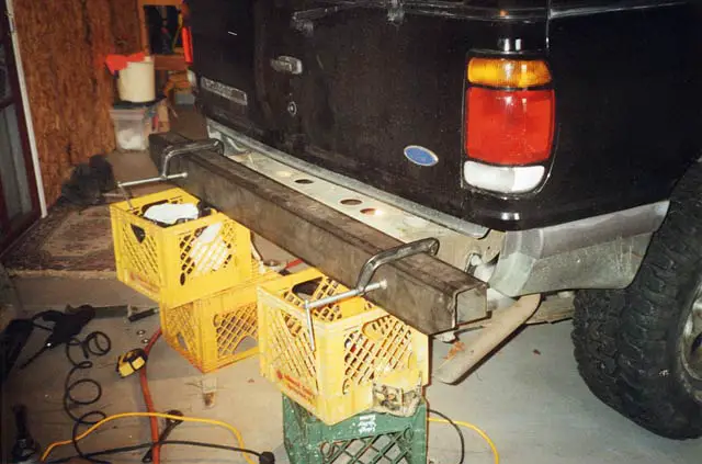

Bumper being installed:
Swing arm mount. This is a 1 1/4" trailer spindle. I added a second plate down inside the bumper for support.
Here is the swingarm fabrication:
Bumper complete (without endcaps, proper latch or license plate lights):

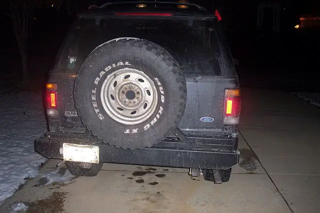

Here's the side view with the tire mounted so you can see how much it sticks out from the rear of the vehicle:
I've already altered the design a little based on what we did. I've changed the tire mount to a round plate, and Ben and I have discussed putting a class 3 receiver and D-Rings on the bumper.

It has been temporarily sprayed with bedliner until I can finish the project.

That looks great guys! I like how it tucks up close to the back of the truck & doesn’t stick way out.

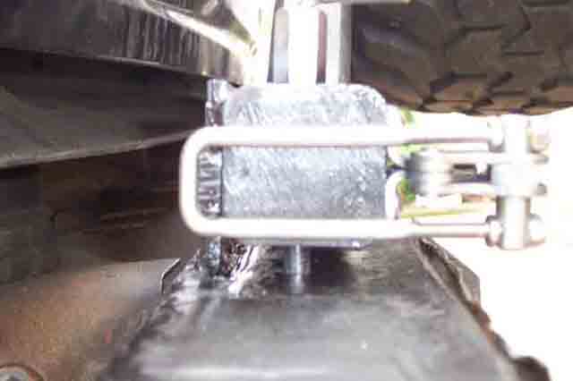

I want to see how the latch works as well. I need to figure out a new system for mine.

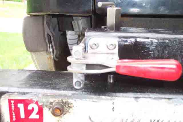

Changed the latch setup.. I had issues with it coming loose on the roadway..
New design is definately a vast improvement.. The top portion is a 5/8" hole spring loaded latch with a 1.25" or more throw. It is secured with a nut welded to the inside of the steel and a 5/8"-11 thread.. The 90 degree latch is a DeStaco 1000 lb SS latch.. The latch is secured using 1/4-20 button cap screws via 1/4-20 holes that have been tapped in the bumper swingout. The latching portion right now 1/4" steel but will be 1/8" steel after I get some.
