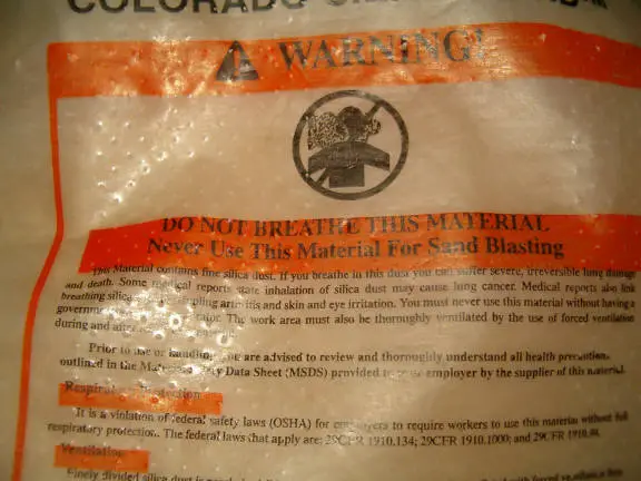

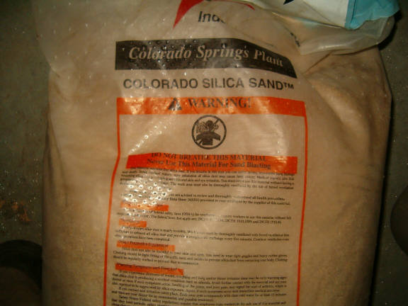

I called a nearby supplier-they sold me this stuff-"great for sandblasting"they said.
Who would have thought? I was getting ready to load some in my cabinet when I saw the label.
IMPORTANT NOTE: SILICA SAND SHOULD NEVER BE USED FOR SANDBLASTING AS IT WILL CAUSE SILICOSIS; A SERIOUS DISEASE OF THE LUNGS. NEVER USE SILICA IN A BLAST CABINET. THIS WILL INCREASE YOUR EXPOSURE TO FREE SILICA. FREE SILICA CANNOT BE FILTERED OUT BY USING A RESPIRATOR AND SHOULD NEVER BE USED UNLESS USING AN AIR SUPPLIED HELMUT IN AN OUTDOOR AREA WITH GOOD VENTILATION. SILICA SAND BLASTING IS KNOWN TO CAUSE SILICOSIS AND IS LISTED AS A CLASS "A" CARCINOGEN. GET EDUCATED ABOUT SILICOSIS BEFORE ENGAGING IN SANDBLASTING ACTIVITIES.
OSHA SHOULD BE CONTACTED IF YOUR EMPLOYER IS USING SILICA SAND IN A BLAST CABINET OR OTHER EQUIPMENT WITHOUT PROPER AIR QUALITY TESTING, SAFETY EQUIPMENT AND EMPLOYEE EDUCATION ABOUT SILICOSIS.
