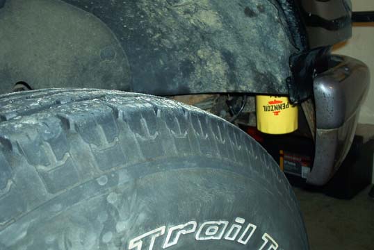

I just wanted to post in here that I got my 2nd tranny filter installed. And of course I will post back with results.

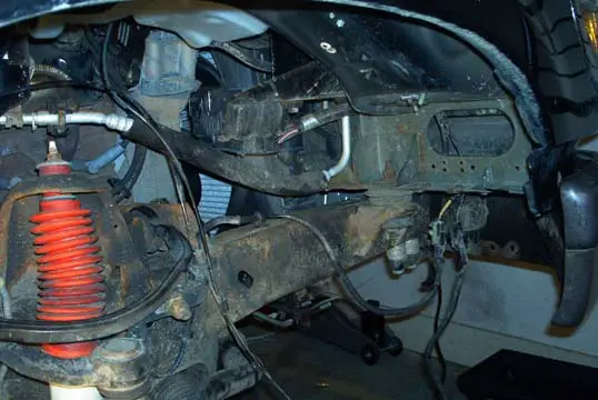

Here's how it's mounted...
View from the drivers side. Well out of the way of the tire.

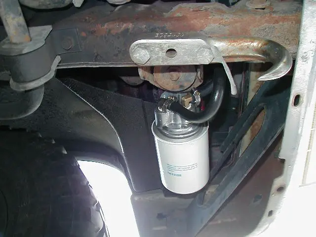

I decided on a generic filter mount rather than a kit, so I could fabricate everything just the way I wanted. I ordered the TD products #:TRD-1028 Single PH8A filter housing from Summit for 12.75. I picked up a bunch of brass fittings from Home Depot, and 3/8" hose from Autozone.

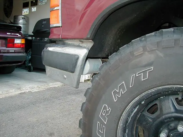

I struggled to find the ideal mounting location. I wanted to run a full-height filter, have it vertically oriented, be easy to change and be out of the way of rocks off road. I found the ideal spot to be right behind the passenger side bumper.
I fabricated from brass fittings the inlet/outlet for the 3/8" hose and the attachment point for the Autometer temp sender.
It is plumbed in between the two transmission coolers. The circuit runs from the transmission, into the radiator cooler, out to the filter, to the auxilliary trans cooler, and back to the transmission.
The hose for the filter required relocated the vacuum reserve sphere for the climate system from above the plastic fender lining. Fortunatley, there was plenty of space below the MAC intake, and there were even holes in the sheetmetal!
I was not impressed that ford ran the transmission lines under the already low radiator. I cut them back to above and behind the radiator and ran new rubber hose. The hose will be permanently secured soon, and a skid plate will be installed.

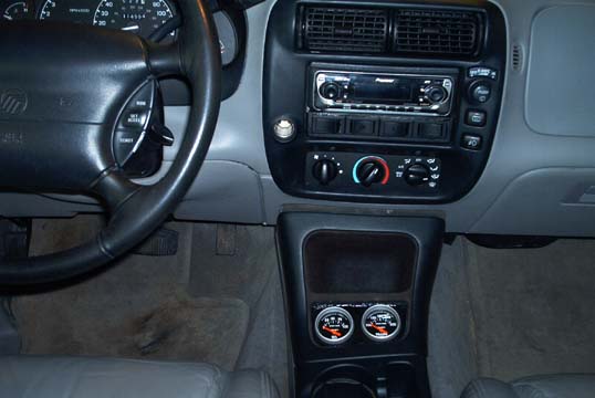

The finished install:
The temperature gauge mounted in the center console:
Your filter bracket did not come with a port in the middle for the temp sender?
Nope. I debated about that fact, but it didn't really matter in the end except for the extra fittings needed.
