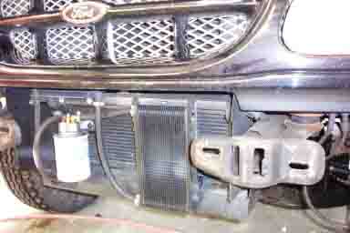

I know our vehicles are pretty different but just as a referance here is mine.
Directly above the filter is the factory aux cooler, and to the right is the B&M after market cooler.
Cut and bend a few brackets. It all was cake.

Thx M
My OEM setup looks very similar to yours, bummer is I do not have a bumper persay, it's integral to the entire front faschia.
To get the exposure you show in the pic, which I feel would be needed to do a proper clean install, the entire front of the S.T, needs to be removed, helped a friend install a trendz grill, it was a PITA to remove all, ST will be on ramps tomorrow for an oil change.
Maybe I can find a location closer to the tranny
Thx
