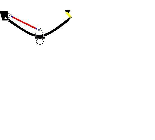

mudbug, I think I found a pic of what you were talkin about. Care to say any more about it?
Id build something like this on the axle tube, it wont limit flex like the straight bar style.
this style works for trucks that dont have or use alot of rear travel, but for a general trail truck it will bind.
I was talking about a shackle/ single link design, im curious to see it in action.
the shackle design has to be triangulated a little like my picture above or it wont work.
thats pretty much it but have it go tho the shackle somehow,,,,noth the spring hanger....
