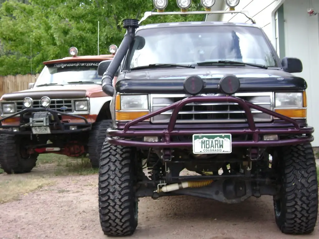

I run 35's on my 94 and only have a 4" suspension and a 3"BL.........
Heres a front view........
And yes I wheel it with only slight rubbing.......
