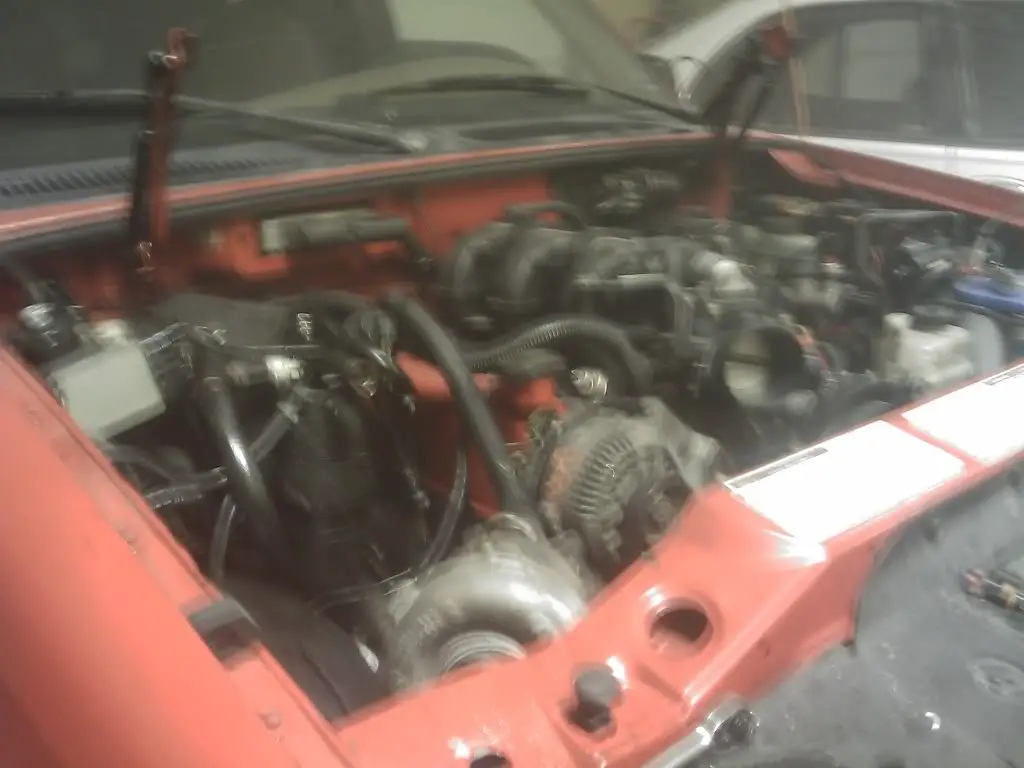

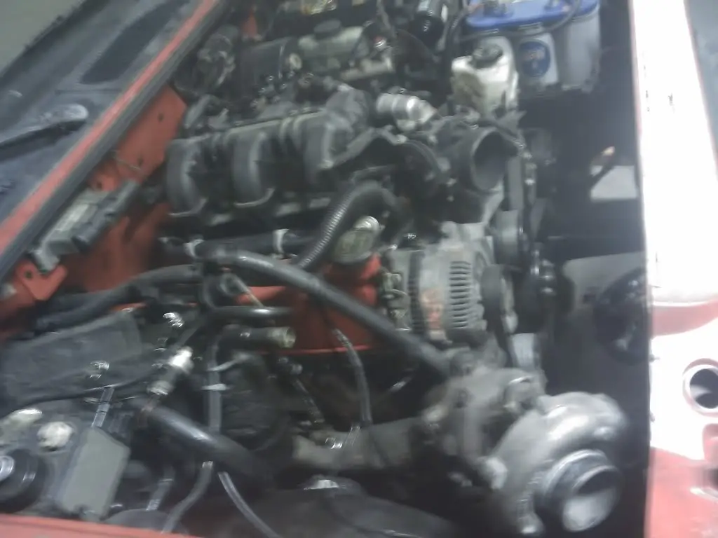

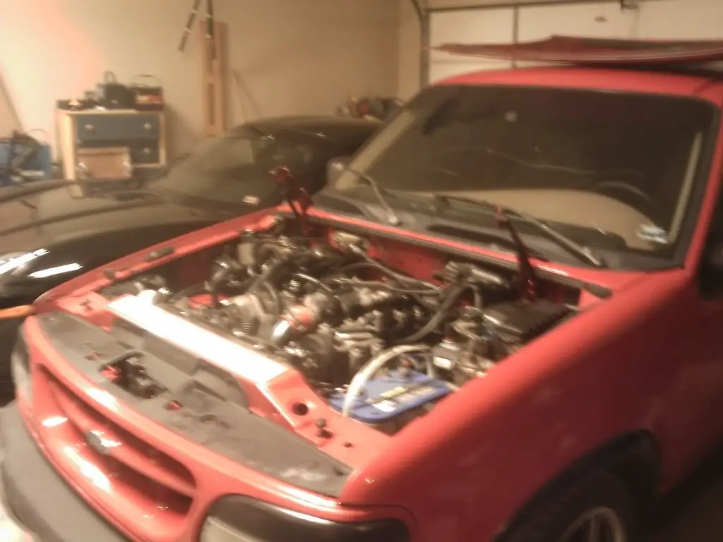

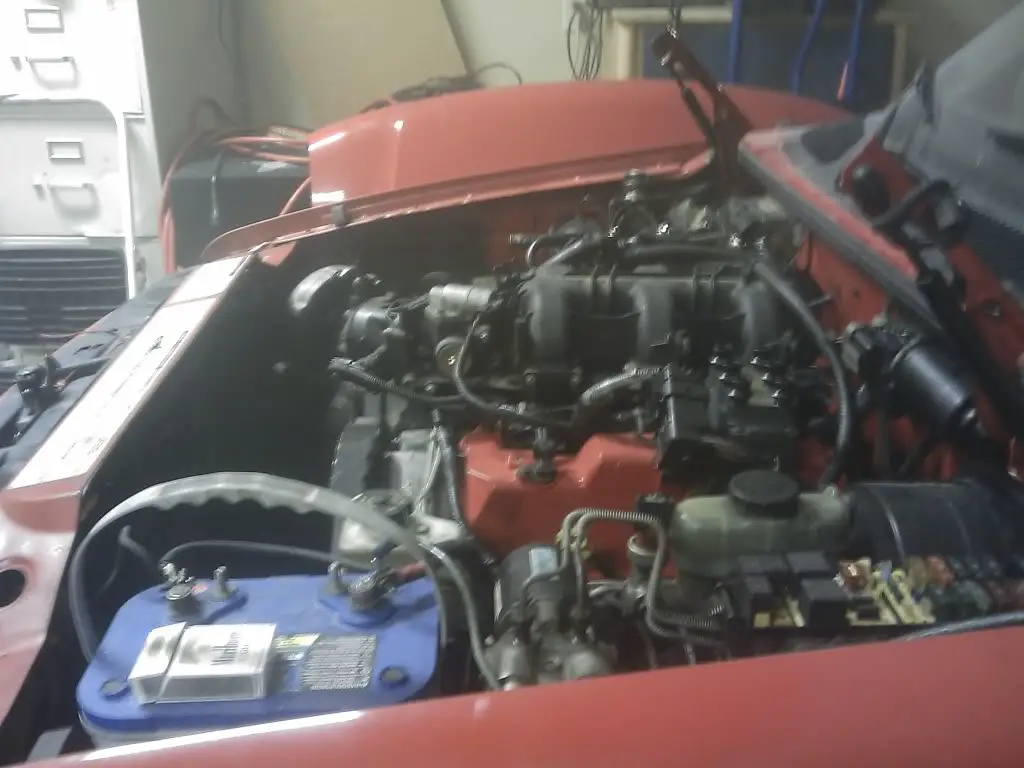

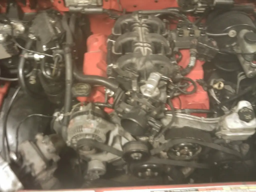

Going in my 96 in place of the ohv, Using the same hot side as the old motor 4.0 OHV.

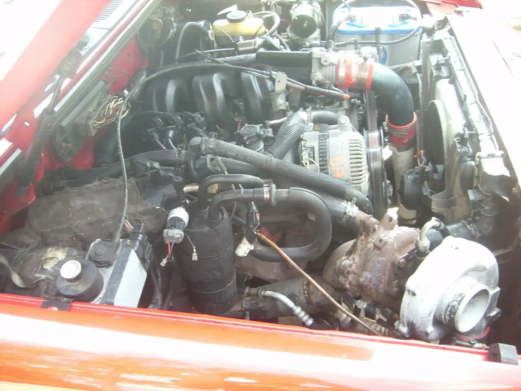

so you had a ohv turbocharged. ive been thinkin i want to do that to mine this summer. if you could answer a few questions that would be super cool.
1: how much boost were you running 10lbs
2: stock internals/compression ratio? Stock Internals & Compression Ratio
3: intercooler? yes
4: are you using a MAF and the stock fuel injection computer? Lightning maf with SCT tuning. Stock Computer
when swapping in the SOHC, where there many changes needed opposed to having the OHV (i.e. motor mounts)? Also, what did you use for a manifold (did you create your own)?
Your 5 speed held up ok with the turbo on the OHV?
did you use the stock radiator? and what electric fan did you go with you don't mind?
Yes, I had the first STS turbocharged Explorer on these forums or I believe anywhere. Many have successfully installed turbo's in these forums.One thing to note is that a Lightning meter is NOT optimal for a blow thru setup! If you don't get anything correct you need to get the MAF,injectors,fuel pump and tune correct. I would recommend a PMAS meter designed for blow thru setup. I sell them and other vendors sell as well. A minimum 190lph pump and min 42# injectors will be needed.-jso you had a ohv turbocharged. ive been thinkin i want to do that to mine this summer. if you could answer a few questions that would be super cool.
