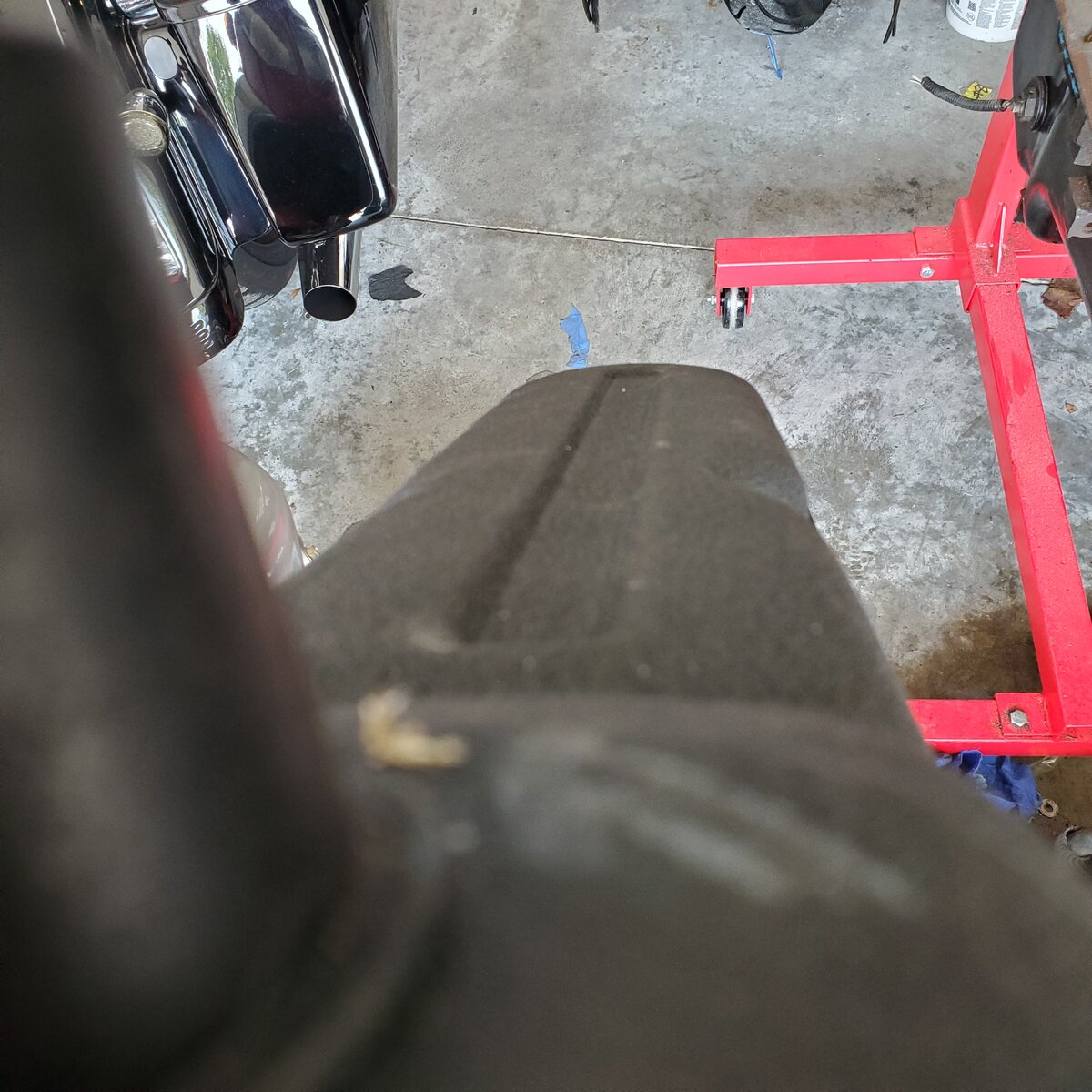

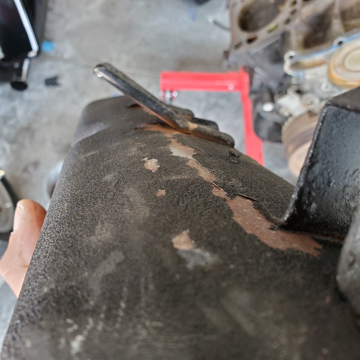

Does anyone know if there is taller valve covers that fit without a spacer between the upper and lower intake? I have 1.6 stud mount rr's... I did massage the stockers (hammered the indention up) that is in the center. They fit after enlarging the holes. BUTTTT.. they are leaking. So I have to take the upper intake off to see what's going on.. rather just buy some taller ones that will fit without a spacer between the upper and lower intake
