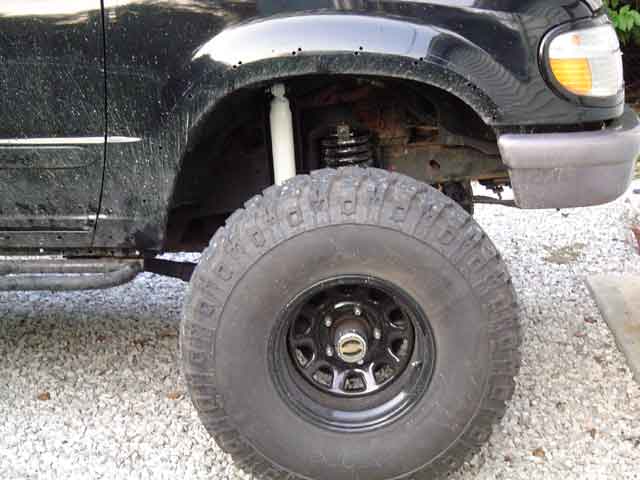

she's got shocks! Rides like a dream (well almost) very smooth and almost drives itself. Only problem is a bit of sway to be taken care of when I mount the other set up front, just have a problem with the bracket, won't work with my steering setup. Need to design and have one made....

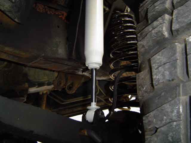

these are explorer procomp 3000 or something like that. It is a very nice shock and way cheaper than the rancho 9000s. Though I like the adjustability of the ranchos.

well I have a bit of a noticeable sag problem
Pass side is 1" higher than drivers all the way around so I think I I will put a 1" block on the drivers side in the rear to level it out. Any ideas? sound like a plan?

you have the rear sway bar hooked up? i thought my springs were wacky way off but then hooked up teh rear sway bar and the front leveled out. with soft leafs in teh back and soft leafs in the front it was flexing on the dirt driveway.
you have new springs in the front right? ide hate to think that there was an inch of difference right out of the box... also reconnecting rear sawy bar (had it disconnected for years) took care of my sway problem. i have rancho 5000 and trac bar front sway bar rear and feel like im in complete control of the truck at all times.

I don't even have my sway bars anymore nore would I hook them back up:D
It has been like this for years. it isn't the front springs it is the rear. It did this with my superlift but with the torsion bars it was easy to compensate for. So I am sure it is the rear and a 1" block could solve it. I will double check on a couple more surfaces befoer I actually go to the trouble.
I would personally rather have a stiff ride and only have to wrry about pulling the pin on my wristed arm than to have a soft no sway ride and hav to deal with sway bars. But that is just me.;)

ooops sorry i didnt read good enough..... you might think im nuts but i had the driver's side sag in the rear so i added another leaf to the driver's side. leveled it and not enough to notice on the trail.
a few years ago i repacked the leaf packs by switching every other spring. seemed ingenious at the time but it only last about 4 months :D

Remember, the driver's side is always going to be heavier since the gas tank and driver are over there, you might want to just swap the leaf packs from drivers to pass and vise versa. You'll hate blocks, too much axle wrap.

I rebuilt mine last summer like you said and same thing. The extra leaf is a good idea. On level ground it is off about 3/4 or so with 3/4 tank. So I picked up a 5/8 block froma truck shop here today. That won't be enough to cause any wrap. Should work out well. Dissadvantage to having soft springs I guess.

Isn't soft springs and their effects kind of a trade off for getting good flex on the trails?

Yes, sir. But that doesn't mean I am not going to try and fight the tradeoffs away....
She rides like a dream down the road, minus the sway, but it rides better than I ever remember, or I am just too happy to be stting up high again with something different?:rolleyes:
