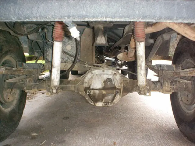

Yep, I was impressed by the amount of rear flex I got. I had been expecting the rear to bind because of improper shock placement. They way they are now they are close to binding at rest. It is something that I need to fix. There is a shot of Michael's truck in almost the same spot (in Gerald's first post in this thread), where he is catching quite a bit of air where mine remains in contact with the ground. His shocks are set up in a similar position to mine, but I have a feeling that his shocks may be too short. We need to crawl under there and get the numbers to find out for sure. Mine also has some nice worn out springs :rolleyes: along with a rancho add-a-leaf and Warrior shackles, sprung over, so I have about 3 more inches of lift in the rear.
How are they set up now? I need to -relocate mine and since you are now springover we may be similar........

Here is a pic of my rear setup. You can see how the shocks come down at a slight angle, into mounts in which the bolt for the shock runs parallel to the axle. I want to move the lower mounts out and move the upper mounts up and in, however much is necassary to run 9012's. I also want to go to a post mount for the rear, that would run perpendicular to the axle and thus relieve a lot of the binding.

Thanks for the pic, I need to move my rear shock mounts on the axle and the frame, I believe a custom crossmember is in order, alot easier to do on a BII then a X I bet........
