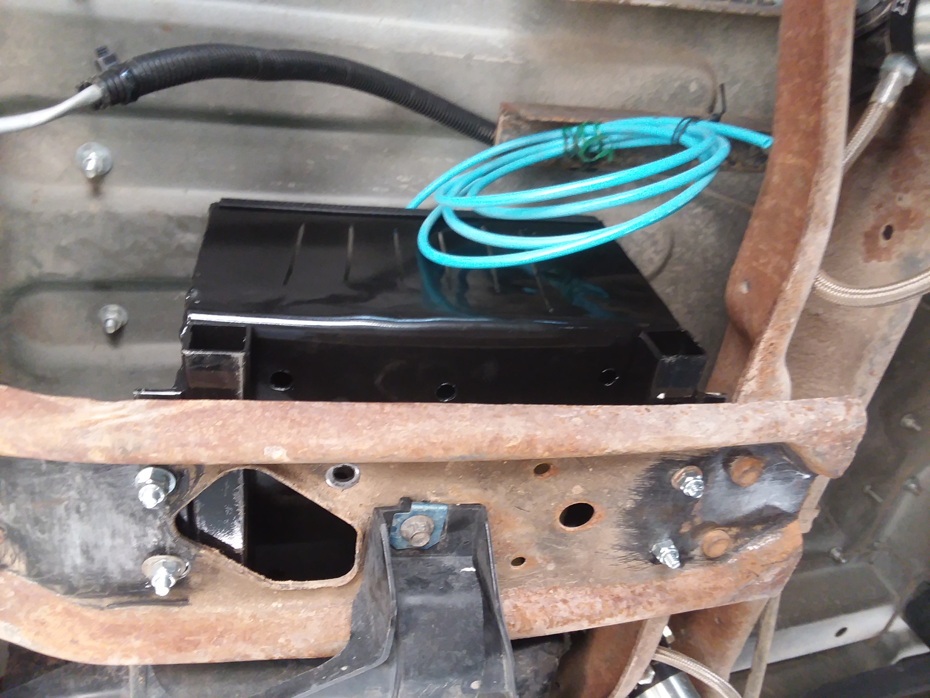

Today's simple work was finishing this cooch box, for install tomorrow. I spent more time on this little thing, than a session massaging the little man in the boat. What can I say? I'm an all in, kind of moron.
Drain holes drilled, vent slots cut, etching primer & topcoats put on.

Ok, managed to sneak away from myself, and finish this cooch box install.
Got the air line, filter, and the edge trim on. Made a template and drilled the holes into the support dealio.
Threw some hardware at it, and locker her up tighter than an iron clad Chasity belt, on a Nunya in training.
There is about 2" of clearance above it. Plenty of room for body sway.
