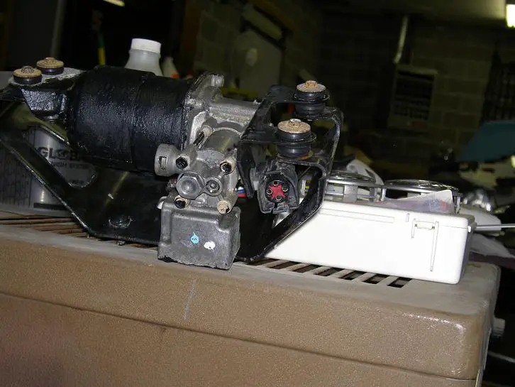

The space above the spare tire has room for a small compressor. This an a stock OEM compressor for the ARC system, I installed that into my 99 truck. The last picture below shows a stock 98 compressor setting in place on my 99 chassis, before I cleaned it and rebuilt the fragile mounts for it. There's a few inches of space up there.
@CDW6212R - does this pump work well to be used as an air source? What years is this installed?

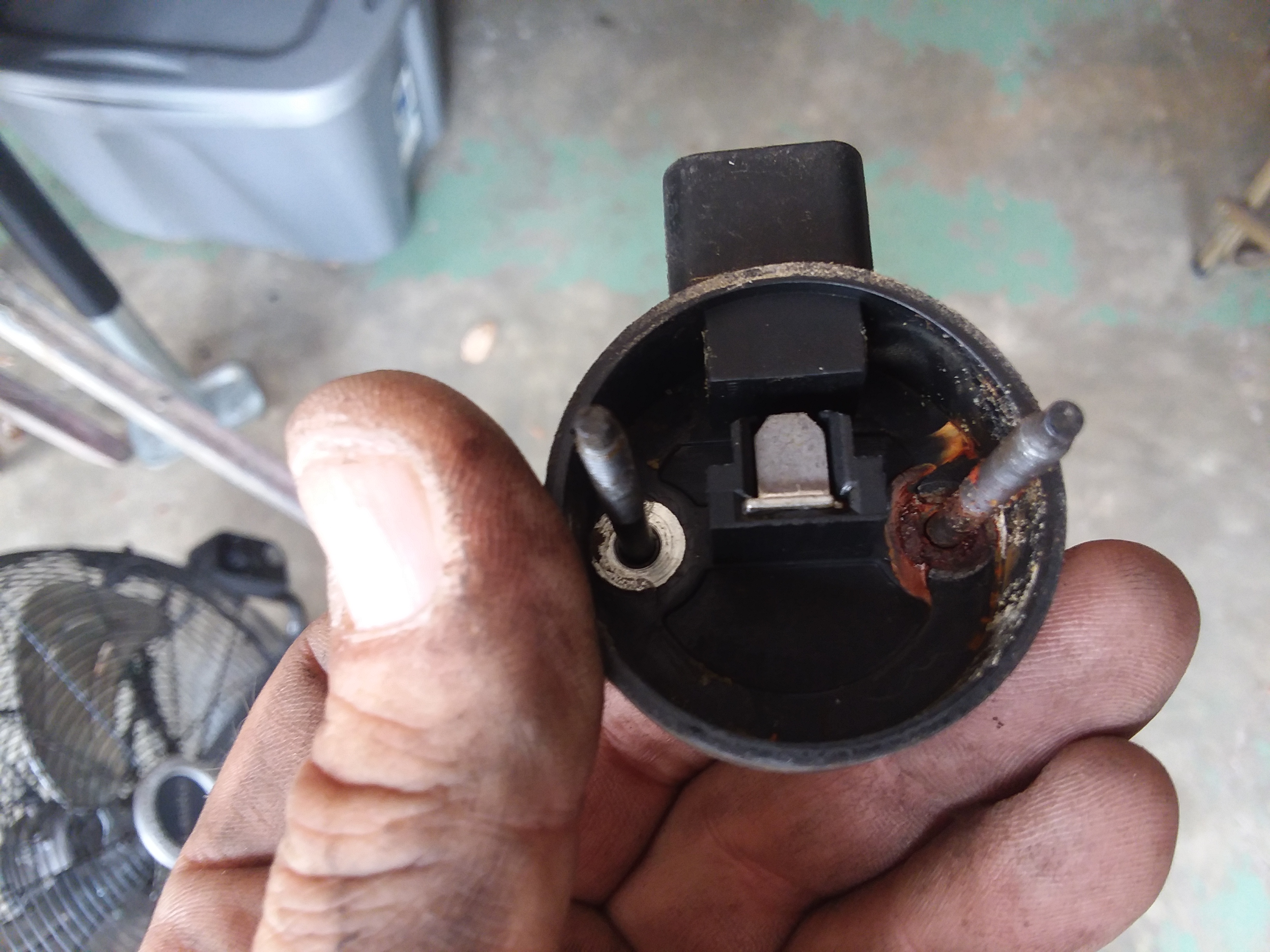

Slight Problem there sir.
Yeah, someone used it for turd tank plug or something. It's in the trash, and a new one on the way. :fart:
Hoping that and a new coil helps with this rotten bastage 1309 code, that was passed on to me to deal with. :shoot:
New cmp sensor and new coil pack. Codes cleared. Test ride completed. Upon 3rd re-start, the 1309 code returned. :banghead:
Flag is still god on the cam synch, and it doesn't make any noise. All I can think of to look or replace next, is the crank sensor. I'm too poor to be throwing good $$ at good parts, and hoping the tuner can help diagnose.

Did you line the cam sync up with the way the old one was? It might of been a tooth off to begin with. Its got to still be off to get the code, I've never seen a Ford crank sensor go bad without some kind of damage.
The wiring to it should be fine since it's the only code your getting.
Never removed it. Just replaced the sensor for it. It looked fine from the top. Do you think I should pull it and reset it? I thought if it was a tooth off, it would run terrible, and the engine seems to run fine as is. Well, I can feel a slight miss at idle, almost like a cam lope, but it runs smooth when on the gas.
The crank sensor wire tip is greatly appreciated! Scratch that off the list. Thanks!
I'd bet your alignment is off. I'd buy the alignment tool and pull it out and reinstall it.
There's a O-ring on it at the top to seal the crankcase. Judging by the job you got they probably took it out to put the engine in, not to re-seal it. When I put a Ford ohv engine together I try to install the cam sync before the timing cover to make it easier to line up. Going by the balancer marks can be tricky.
