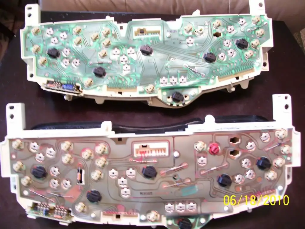

I received the cluster from Joedirt and removed the stock cluster.
They are different from one another, and we already knew that. I had to take them apart and swap out the side gauges to make them work for a couple of reasons.
Here is the backs of them both. The 95 on top, the 97 on bottom.
Everything seemed to be fine, but the OIL gauge pegged out on it. I need to try to either swap the center gauges and return the side gauges or try another cluster to make it right. I'm not sure.
I did change the needles to RED.
The earlier models had different oil pressure sending units also. You have the two different kinds. The later type is just an ON/OFF pressure gauge. I'm not sure what the best combination is for those. I've wished to be able to add digital gauge readouts behind the stock cluster gauges.
The thinking was by using the stock gauge and the stock sender it would work. I have no idea what happened...lol
Must be something in the circuit board.
Your 95 cluster has an oil pressure gauge that can be modified very easily to get the gauge to actualyl reflect the real oil pressure. Granted, you'll never know the actual PSI, but instead of just sitting in one spot when you have at least some pressure like most, the needle will move, so you will get a feel of what is normal and what isn't.
There is a thread on it somewhere, its a quick modification and since your cluster is already out you should take care of it now. You do have to buy a specific oil pressure sender for it to work as a real gauge though. The details are in that thread...

Since you have the dash apart, convert the oil pressure to a real oil pressure gauge. It looks like you will have to buy a new sender anyway to get the '97 dash to work in your '95.

Not sure how swapping the oil gauge alone affects things but since all you you would do before was remove a remove a resistor you should be good. I would call autozone and tell them you need a replacement for this ford part E4ZZ 9278A or if that doesn't work just get the ford one. I'm almost 100% that it will make your gauge work correctly.

Hey Chris, yeah I mentioned that I might swap the center gauges and return the side gauges back to the 95 cluster and see how that works. This is the next thing I am going to do.
Going to do it in the AM, and will post back how it works out.

I thought about it for a sec while sitting in this parking lot waiting for this free move to start and the gauge pegging is exactly what should happen when your stock gauge has had the resistor removed and is installed back in the truck with the stock on/off style sender. If having a real oil guage is something you want to do, swap in the real sending unit and your gauge should work great.
I think when you swapped the old gauge in the new cluster , since the new cluster never had the resistor, its already 'modded' :) I hope this is the case because I will gladly swipe the gauge from my 95 for my 00.

No need for an aftermarket gauge.
Replace the 20K resistor on the flexible circuit board on the back of the cluster with a wire, and change the sending unit on the engine block, and you have a real, working gauge.
The factory wiring of the gauge is shunted - it shows none, low and high pressure (only 3 states.) By converting, you get a full sweep readout.

2nd) The gauges are all working after swapping the centers and returning the sides into the stock cluster. The 97 speedo/tach works perfect. This was my main concern for now. One day when I am bored and feel like converting the oil pressure gauge to a real one, it will happen, but for now, it works.
