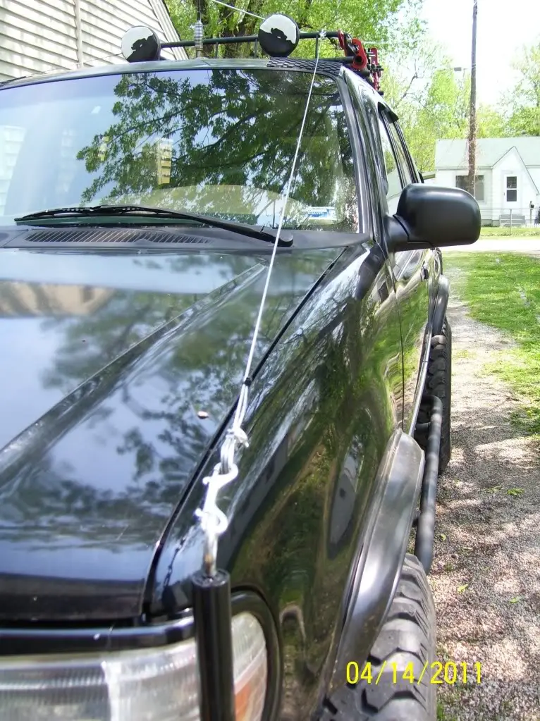

I cut 7" off the front cable mount tubes, re-drilled them, and slapped some rubber pads on the roof.

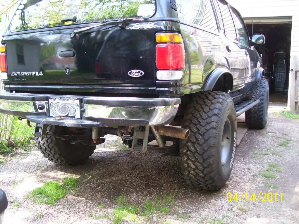

Had to put the War153 shackles back on (grrrr) to get some lift from my ever shrinking leafs. Got 2" out of them surprisingly. That should help until a new set get installed.
I also loosened up the U-bolts and shifted the axle over 3/4". Some how when the rear took that hit (rock wall) it shifted it over. I noticed the U-bolt positions on the axle tube and realized it. I had thought it was moved over that far from the rear frame rails being tweaked :dunno:
I used a BF breaker bar and tightened up them U-bolts. Should stay in place now. :)

1st off, the lowered cable mounts.

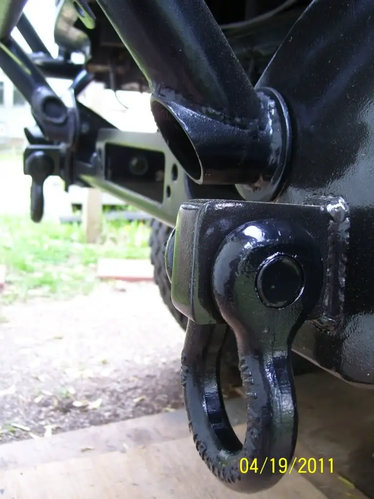

The dreaded war153 shackles back on.
This is the space I need to run with the 35" tires on and hopefully when I get around to building the F-150 packs it will look the same.

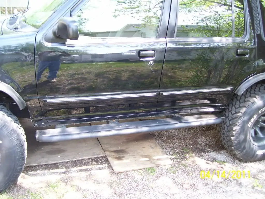

I decided to get rid of the rest of the tupperware on the rig, so the rocker trim came off. I have been reluctant to remove them from fear of finding the dreaded cancer under them like so many have discovered. Too my shock & awe, they looked as good as new on both sides and a factory finish paint still there :bounce:
Looking down the sides of the exposed sliders.
