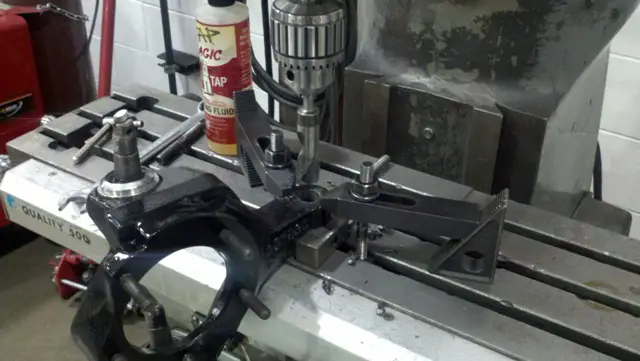

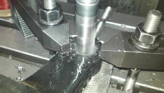

Here is a few pics of drilling the knuckles.

Think I paid $90 something for mine from summit when I ordered my winch. But was nice with the mill, super control of its speed and pressure and used a half bottle of cutting oil. I also actually had to have another pitman arm reamed back here in Salt Lake to move the high angle tre to the top of the pitman arm so the tie rod would clear it at full stuff. So its been used twice.
I know you have/had access to thaat great shop, pluss you own the reamer. Would you be interested in reaming a pitman for me when i get to that stage on my build? Prob will do my knuckles same way you did, i can handle that at home.
