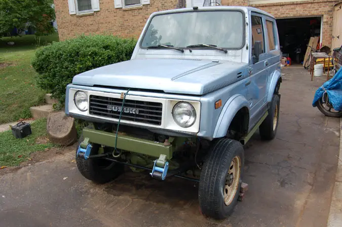

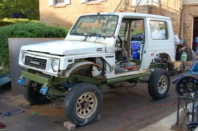

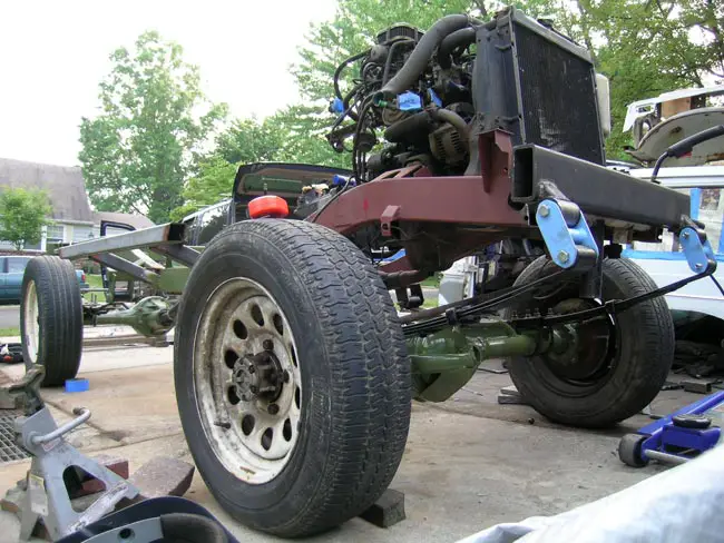

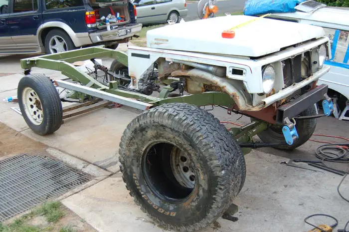

To update this thing, we are going to finish up the front suspension tomorrow. We're going with our own steering design cauz now that the axle is SOA, the steering links are interfering with the leaves. We're going to switch to heims to make things simple (no reamers needed). And just for fun, we're going to go with 0.5" heims (small!!!). Static loading limit on a grade-8 0.5" bolt is over 17,000 lbs (single shear) so I think 0.5" will be plenty for this thing.
