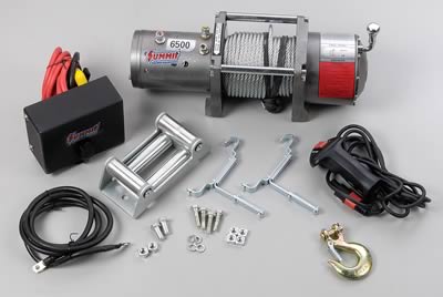

This is the 6.5k winch that we aimed for (mounting pattern and dimension). It will be installed once the vehicle is out in the west.
A GM alternator will also be swapped in to counter the winch's draw.
http://store.summitracing.com/partd...part=SUM-930005&N=700+314452+115&autoview=sku

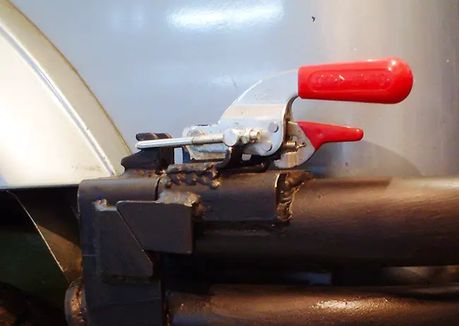

Have any close up of the cam lock on the rear bumper? i need ideas for mounting it since i have to repair my bumper soon.:thumbsup:
We didnt go with a camlock design, we just used the run of the mill swingout bumper pivot that you can buy from E-bay (which is nothing more than a trailer axle with a machined sleeve you weld to).
As for the other side (the side that locks it in place), we used a toggle clamp with a safety lever.
The two "wedges" in the image below keep the bumper vertically aligned and takes any vertical load on the driver's side
Well that's latch i am looking at getting for my rear bumper even tho i call it a cam lock
just gotta the best to mount it on my Dutch door style swingouts.

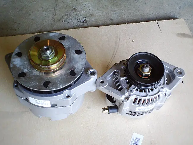

Started the GM alternator swap this afternoon.
Alternator is spec-ed for a 1983 2.5L Camaro, 94 amps -- 3 o'clock wiring position.
GM alternator on the left, Suzuki alternator on the right
Alternator brackets modified for the larger GM
So hopefully tomorrow all I have to do is the wiring mods.

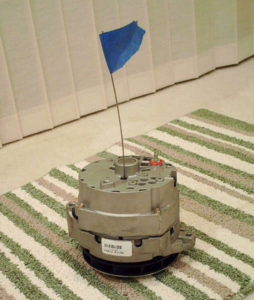

Okay that 3 O-clock position of the alternator was going to make wiring a bit difficult so I rotated it to a 12 O-clock position. I used a small section of a bike's brake cable to ensure the brushes did not come out of their sockets (tape on the end so that I didnt poke my eye out during alignment).
My what a beautiful rug :p:
I also had to re-clock my alternator when I did that conversion on my Sammy. Made the fit a LOT better.

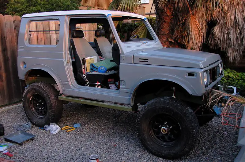

Update on this thing .. my brother's in the middle of painting it and other little cosmetic stuff. The paint is Rustoleum's Professional - Smoke Gray with a White roof - by the quart (maybe $14/quart) via a roller.
