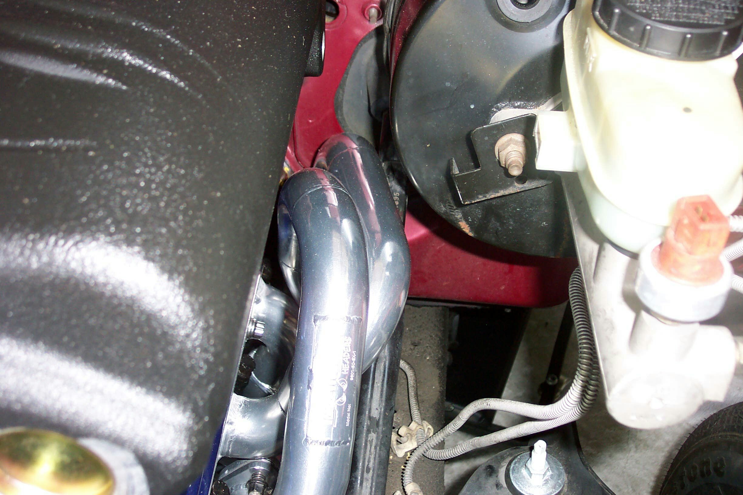

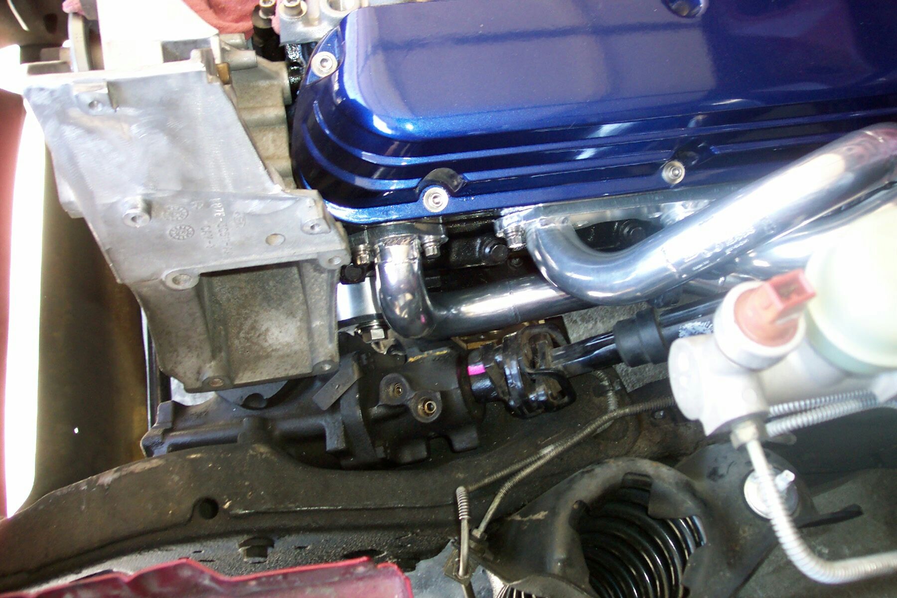

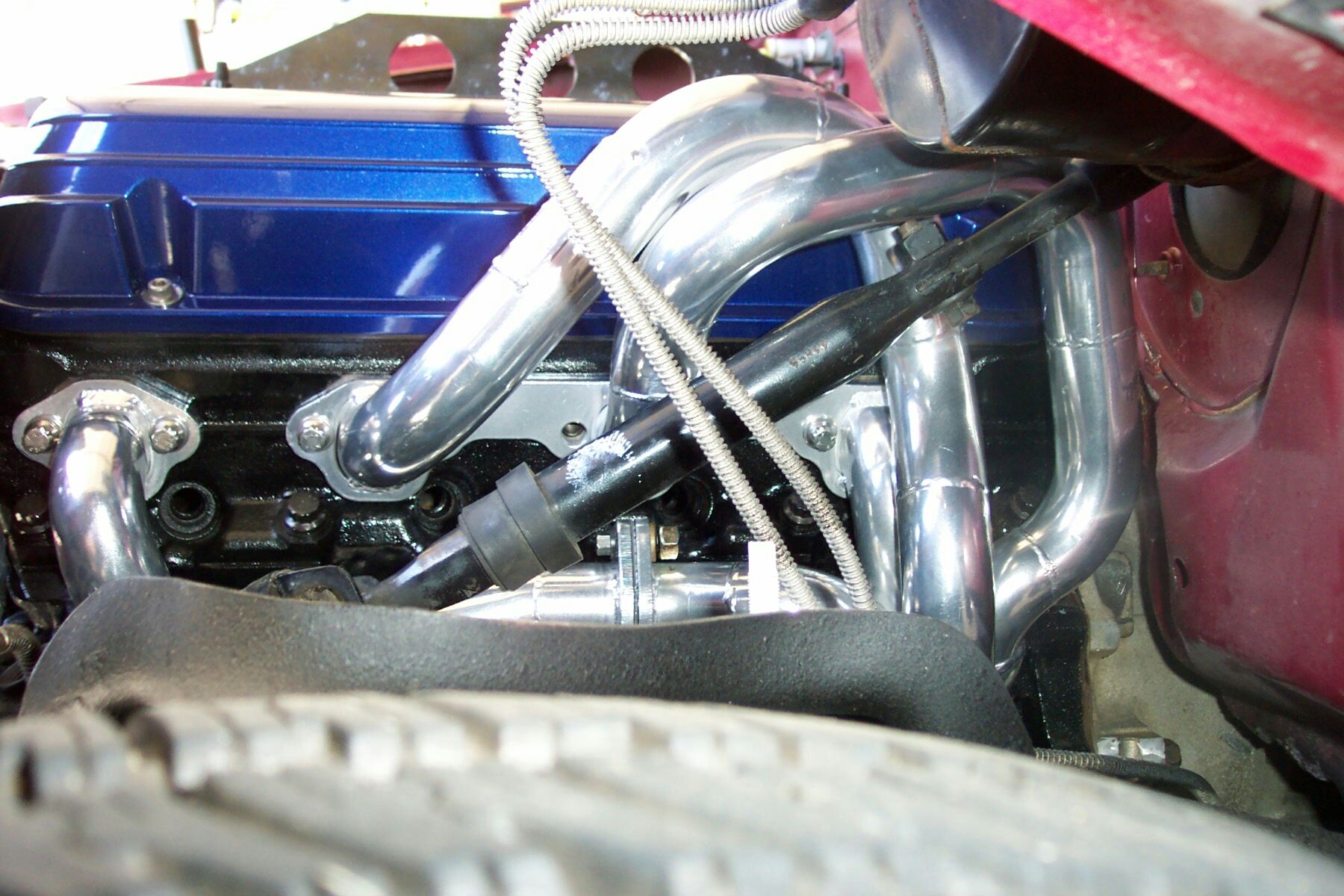

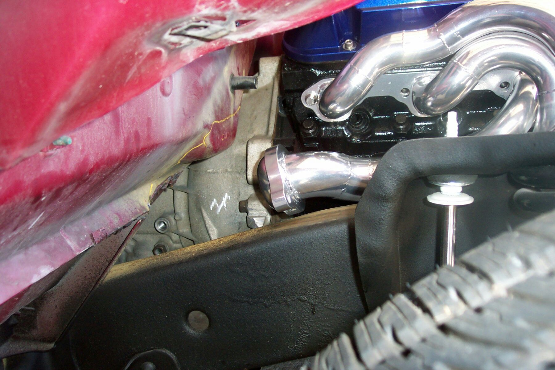

You're correct, if you have a Ranger with the coil spring front end (1983-2011). You will need Torque Monster Swap Headers. I've attached a few photos of how they fit. And, yes they will fit GT40 & GT40-p heads!
If your Ranger (1998-2011) has the torsion bar front end, then standard Torque Monster Headers will work fine.
