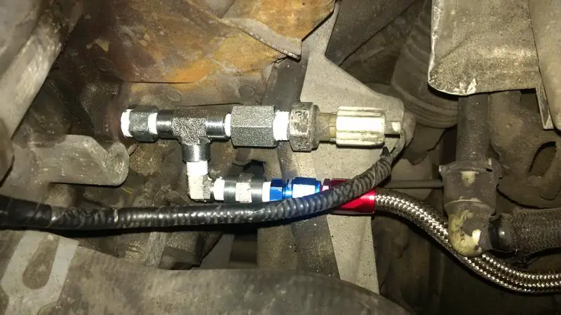

I went to install the oil feed line tonight, (after being pre-occupied with house stuff), and......holy smokes. Willzilla wasn't kidding. I can barely see the sending unit. How am I going to do this??
Too late in the night to start this. Maybe I'll take a trip to the plumbing shop tomorrow and see if I can find an extension.
unbolt the ac and power steering bracket. its just 3 bolts. then you should be alble see get to it better
Thanks Tim!
This might save me a ton of cursing.
Okay,3 bolts and the power steering/air conditioning bracket is loose.
Not enough room to get at the sender...
Need to remove the air conditioning compressor from the bracket to make some room. This means the battery and battery tray needs to come out. Then, very little room to get the compressor off of the bracket. After that, my oil sending unit comes out easy.

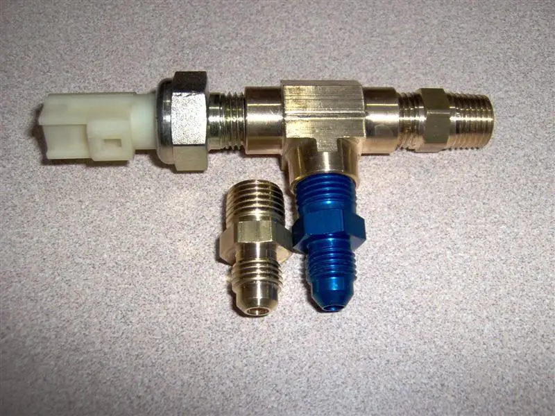

I find that it's 1/4 npt.....Not 1/8 as I had planned with my T. I sure hope I can find what I need locally tomorrow so I don't have to do this twice.
Thx Tim. I'm going to start with Princess Auto, then work thru home depot and rona.
Most guys seem to make their T's from places like this anyway.

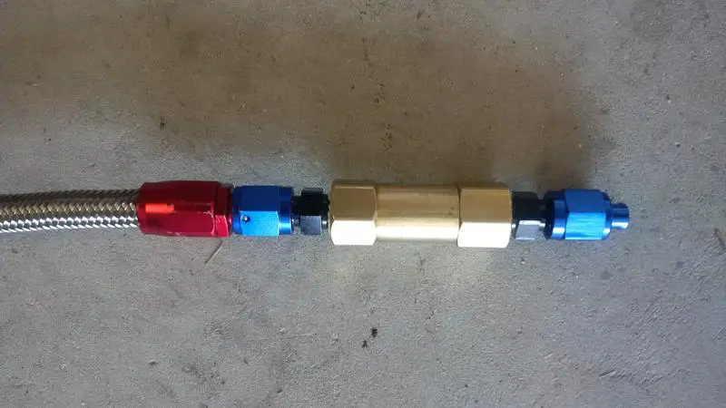

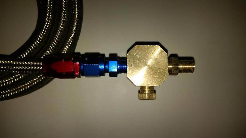

farm implement store to the rescue.
Took 2 trips, as on the first config I ran the oil straight up, and it would be in the way of my power steering/air conditioning bracket.
I am using a 1 way valve at the other end of the oil feed line, and have just capped it for now. The one way is just to stop oil from running in to the turbo when the truck (oil return pump) isn't running. Hopefully, avoiding some startup smoke.
In the next day or two I'll run the oil feed to the back of the truck along with electrical for the oil return pump.

check valve
hey where did you get that check valve? I'm having trouble finding specs on check valves. No one really mentions temperature ratings, cracking pressure, oil safe, or if they are true 1/4" all the way through. I also would like to see some pressure drop graphs. Are you sure you don't need to step up to a 3/8" check valve?
I had something like this mind... http://www.homedepot.com/p/HIGHFIEL...Check-Valve-F100HCV/202274775?keyword=F100HCV
Mcmaster Carr is where the check valves came from.
http://www.mcmaster.com/#standard-check-valves/=sqi5n0
Since my oil feed it AN4, I don't need a bigger check valve. In testing yesterday, there is extremely high flow rate thru the check valve (I should have taken a picture of my garage floor).
I did look at different sizes of a few mcmaster carr check valves, and even if you were ordering a larger inlet/outlet the sealing ball was the same size internally. I wouldn't worry about it on the feed side though. Trust me, the turbo will not starve from lack of oil flow to the turbo.

great idea on the check valve deal. I ordered my 1/4" quick open check valve yesterday and got it today. It looks great and I can open it with the air from my lungs, making it perfect for stopping a few feet of gravity weighted oil.
