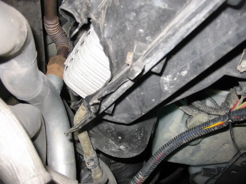

Good to know that heat shield is necessary. Too bad we found this out at your expense Jon.
I would patch it up and then make an aluminum heat shield. Rivet it to the box, but put some space between the box and heat shield if possible, just to allow some air to get between there. It will help reduce temps of the box. If the aluminum is nice and shiny it will help reflect some of that heat.
You can get some heat shield products made by DEI at Summit Racing. They have all sorts of heat protective materials. Some are self adhesive so you can stick the stuff to whatever.
Just take a hammer to the header.... "clearance it" LOL
Man, you guys if I could get in between the header and hvac cover panel I would patch it, however, I do have a new --rather -used one which will bolt right in place.
Once I gain enough access why not just put the new one with heat shield on there?
I do appreciate the suggestions though. Anything to help is appreciated, and, now that I finally have that headers sealed I really hate to break it. Maybe once I am really in there I will see a short cut.
I think I could fit 2 -10" pushers in front of the ac condenser very easily. I noticed my plastic fan has cracked, so now I would like to switch back to the metal one as I do think they actually flow more air. The hunt is on.
OK, here is what I am up against. Getting a good patch, with room for the heat shield and a space in between will be very difficult.
However, I have this
So, Dang. Looks like I have some wrenching to do.
can you put some heat wrap on the headers?
Yikes Jonny! If I know you, you'll figure something out, creatively speaking. Good luck bro.
Hmmm, I am tempted, however it will mean no further warranty support.
That's rediculous. I've seen so many wrapped headers and the only place they had issues was where it wasn't wrapped... Even then, it was just rust which would have happend on all of the header had they not been wrapped..
That looks tough, and Mark has a good idea to help. I'd put the new AC box in and shift it to the right if it will go at all. Make another aluminum sheet barrier to attach to those OEM studs. Also, if possible, run some piping from the front to that area, get a high pressure area at the radiator to push air through pipe to the spot.
If you can get any real air flow through the space between the AC and header, the heat will not be too much.
Let me know how much space you end up with, to help with building headers. I just found out Canfield heads are no longer available.
Well , My friend Mark came by and with his help we have upper intake, coil packs and fuel pressure regulator pulled, and new HVAC cover installed.
The cover needed quite a bit of persuasion and manipulation to get around the evaporator while squeezing between the header, but I was able to leave the header installed. :thumbsup:
Now to wipe it down a bit and throw it all together. The powdercoating really could be redone as I did this with a bad batch of clear I have fought. Should I take time to re powder coat my upper intake and tube?

Well good, how much space do you have there now?
Waytogo dudes. I knew you'd sort it out. Go for the powdercoat. Just hit the porch while the baking is taking place and it will done in no time. :cool:
Brad
To do so means a whole bunch of dis assembly, I have decided to put if off for a while.
Don, it looks like a strong inch now. I would think with the shield that is plenty.
Good, I was worried that it was more like 1/2" and would melt it again.
