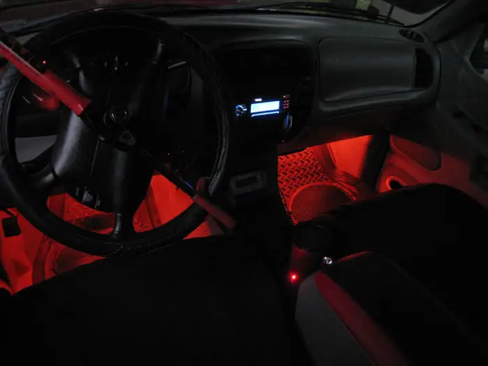

Just did the same thing to my friends Mazda Speed 3, Same exact setup as I did in my Explorer, except we used red LEDs for his. 6 33,000mcd LEDs on each side.

looks pimp, kinda too bright though :D (which is good)
The pictures were a little over exposed but it is fairly close to the actual brightness.
