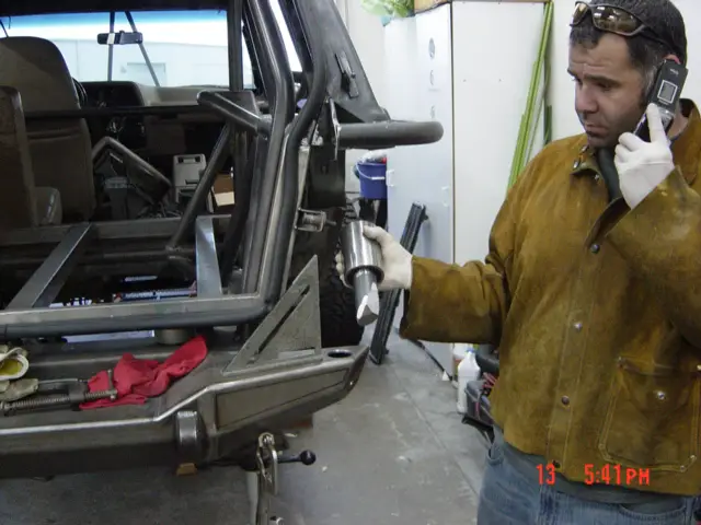

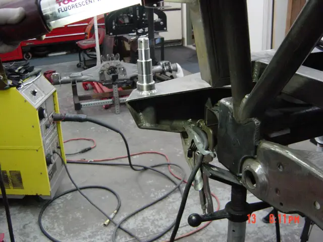

Start up of the rear tire carrier mount. Winter decided to go back to the single pivot mount. I will let him tell you the reason for that. Anyway, here are the beginning picture's so far.

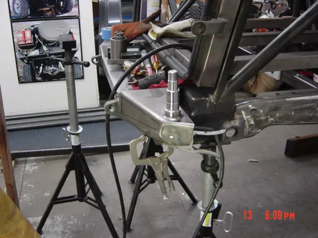

One more picture.
