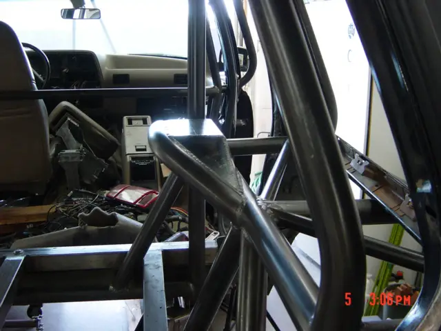

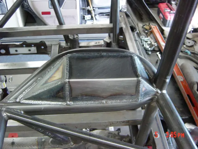

Well, Winter was working on it yesterday and finished up welding the plate's cover's on the shock mount's.
After the last two pics, i am offically aroused. :jawonfloor:
...:eek:...That is some of the finest welding I've ever seen...:biggthump
Nice work. That doesn't even need cleaning up. :notworthy:notworthy:notworthy:notworthy:notworthy
