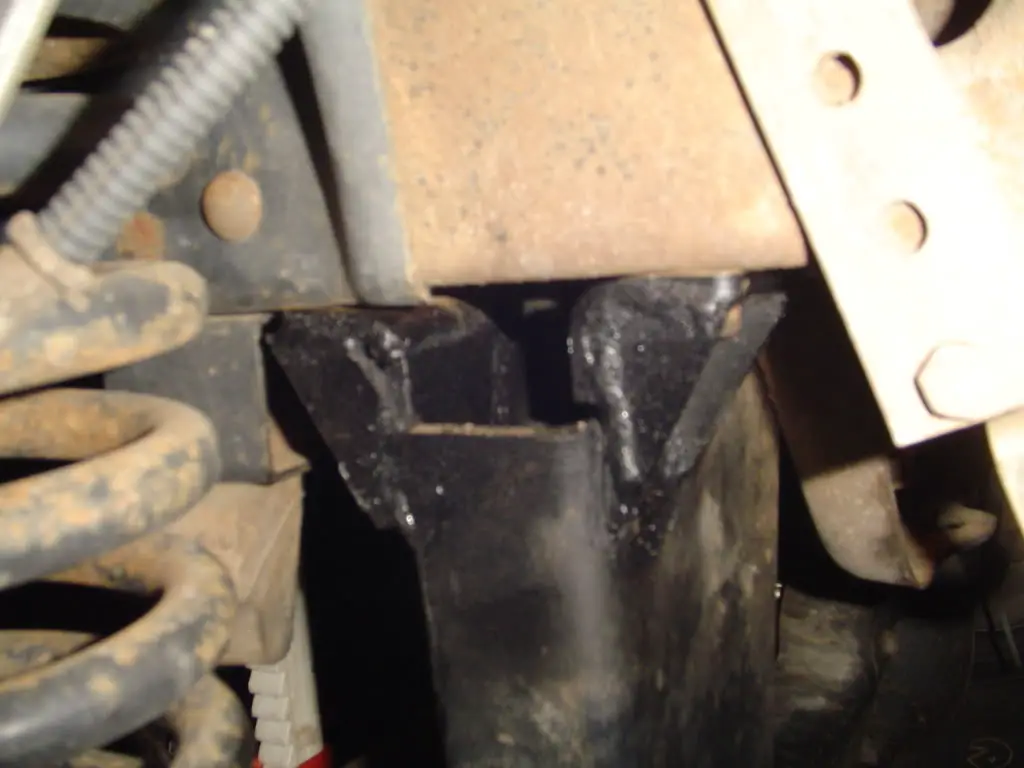

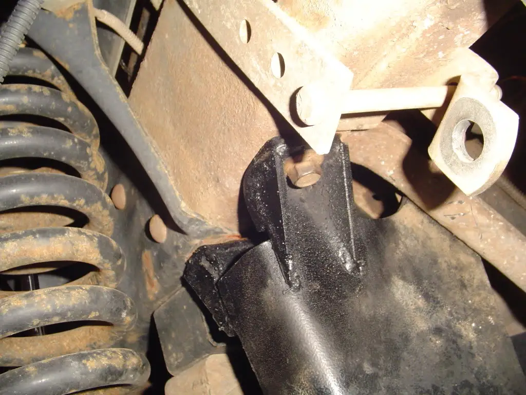

before you put on your lift, make some gussets for the drivers side TTB drop bracket. mine broke about 8 months ago and i just finally got around to fixing it.
you can actually see where mine broke on the left (rear facing) tab.
