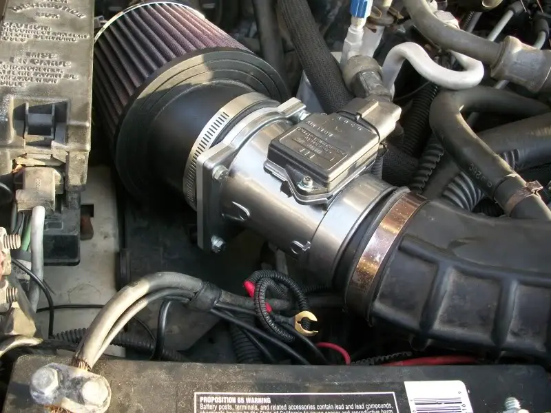

the new maf sensor:

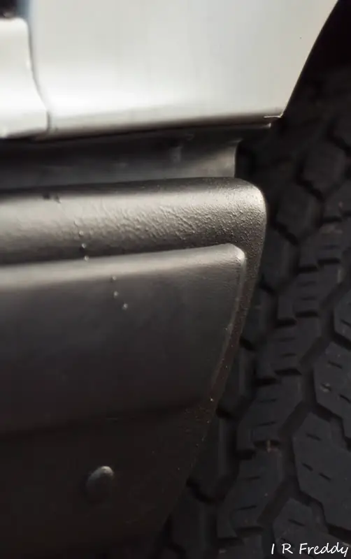

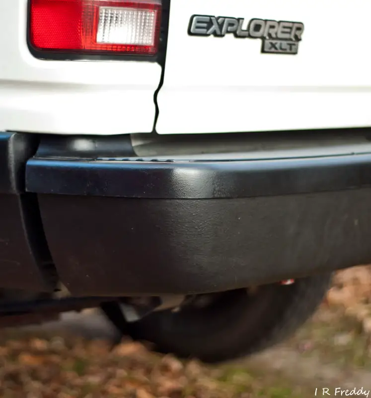

and the painted area behine the grille:

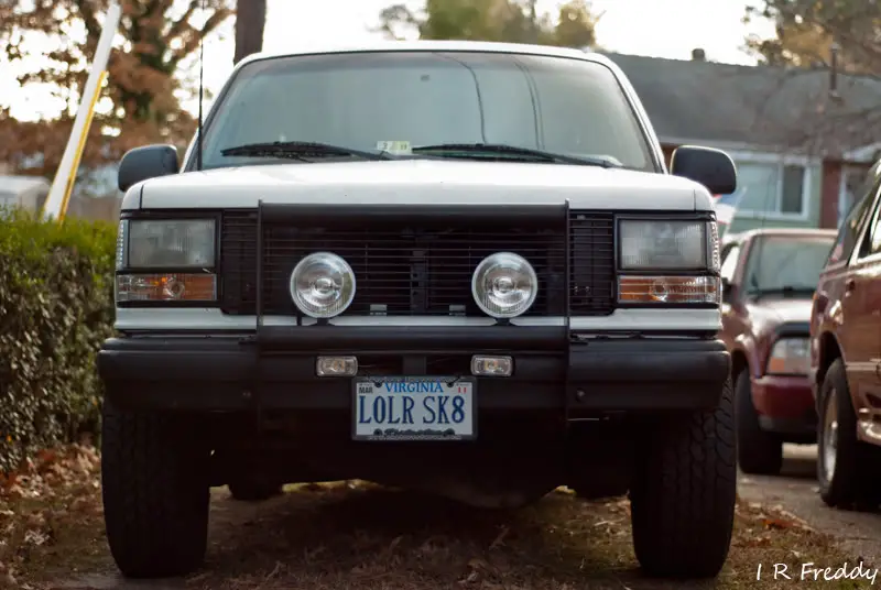

i will be painting the grille, bull bar, front bumper, rear bumper all with bedliner.
and at some point paint along the sides of the truck following the top of the bumper line in bed liner
...Do you have a part number and a price on the new MAF?
its a 70mm 94-95 Mustang GT Cobra maf. i paid $45 shipped for it.
it doesnt fit with the stock intake hose, i had to shove a rubber coupler into the intake hose and the other end into the maf. its only held in by the lack of movement.
it is a direct bolt-on to the stock explorer air filter tho
^^ive gotta do that to my bumpers now. that looks good with all the black Xeek :thumbsup:
it does look good! just check out my junk for proof :P
