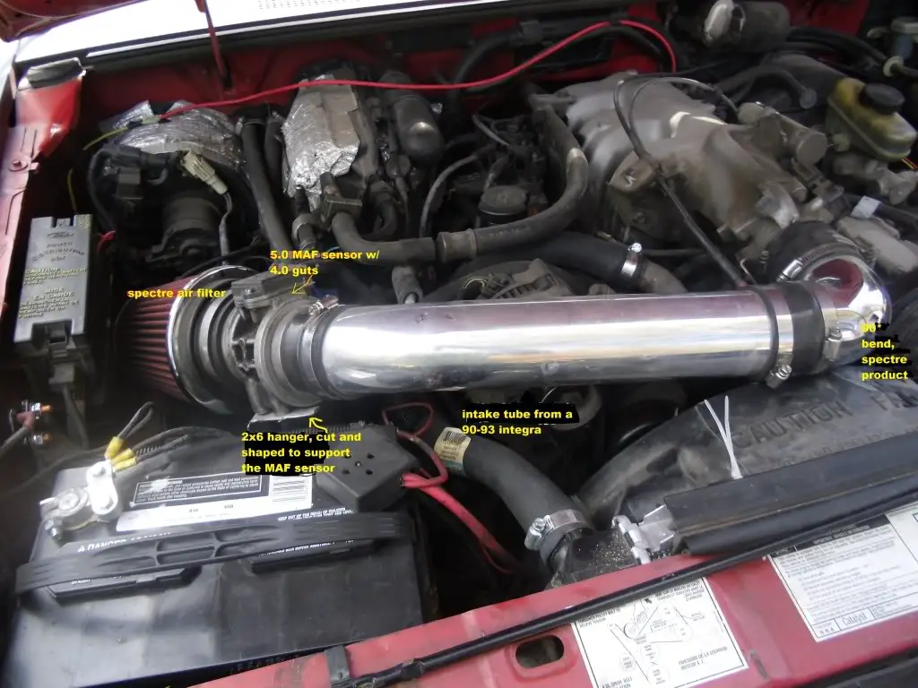

You can put a small filter at the end of this line
look at :biggthump
:exp:
