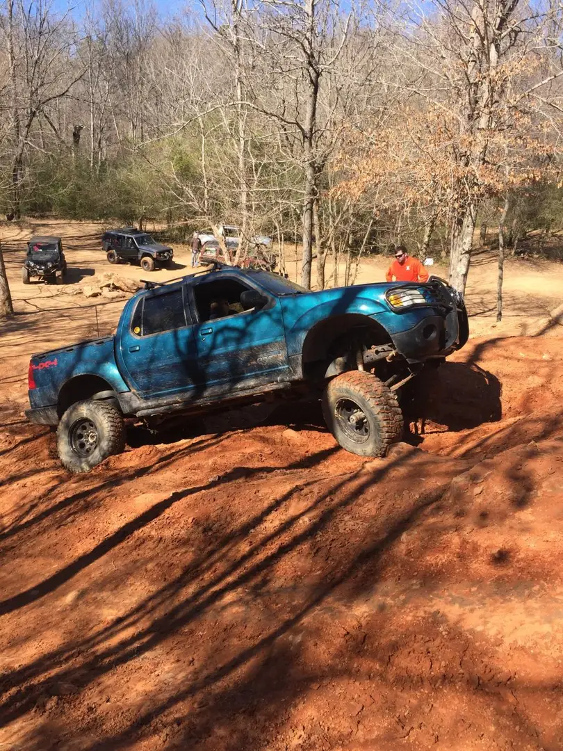

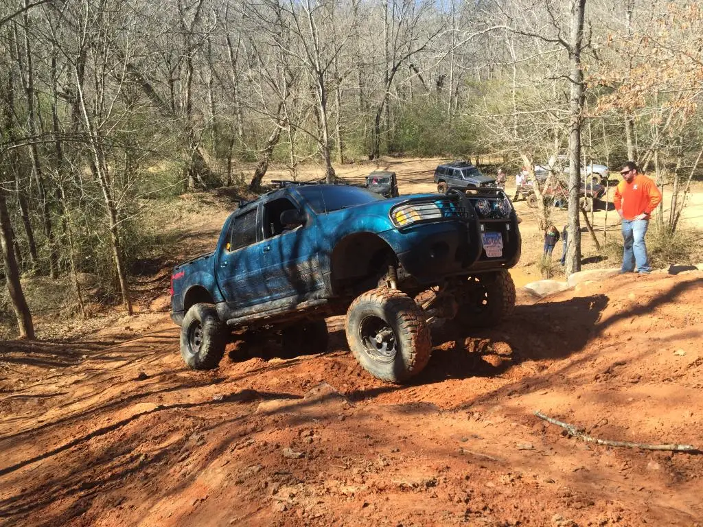

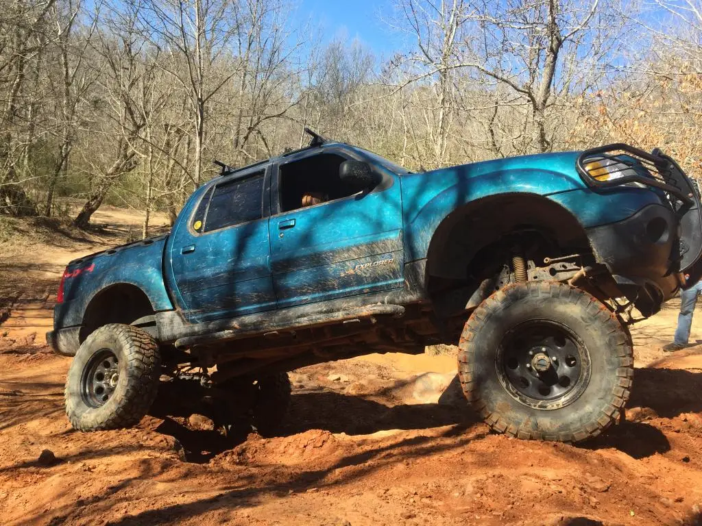

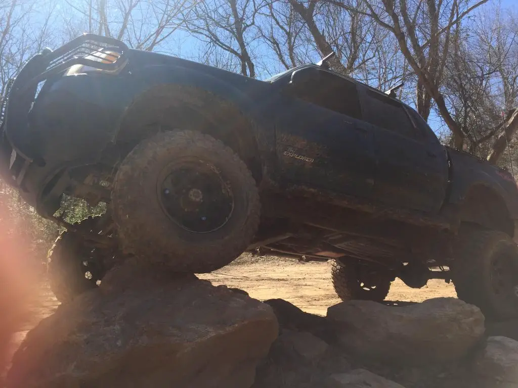

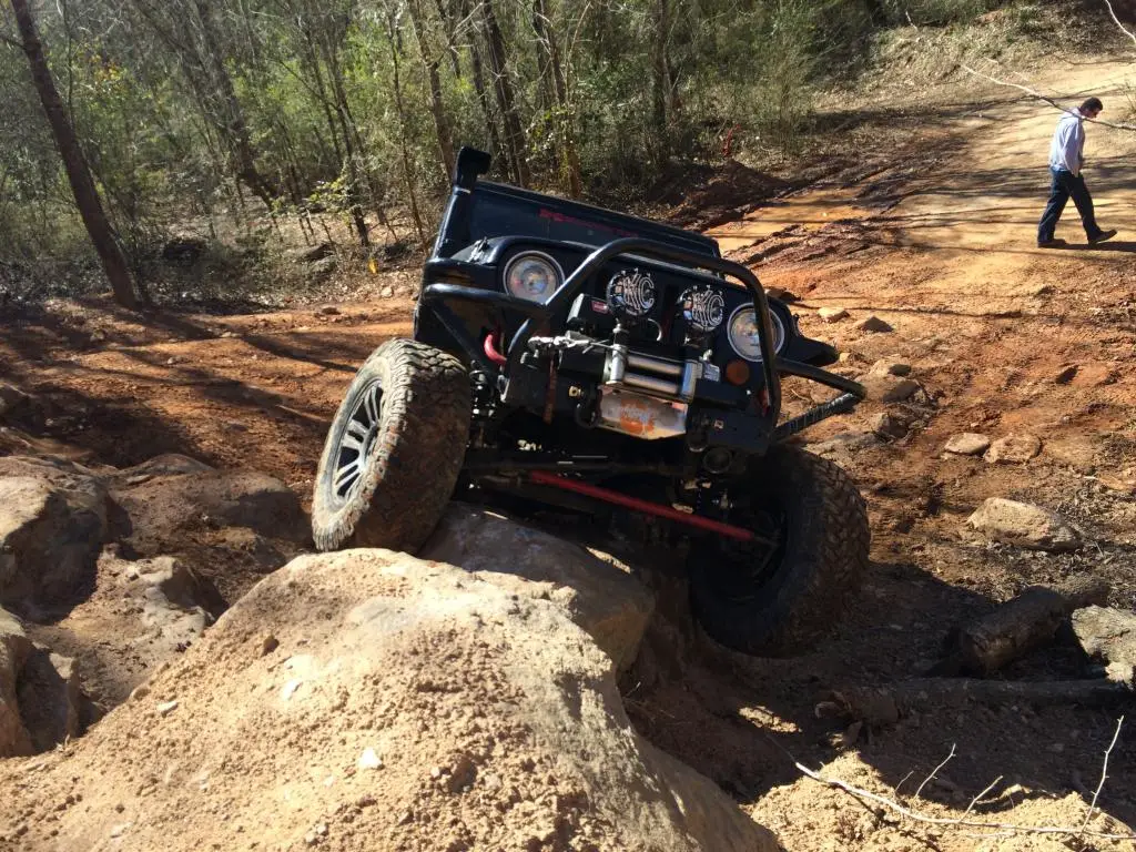

A few pics from last weekend giving the SAS a workout. Sadly no pictures from the harder stuff in the rock gardens but this was a challenging hill climb.

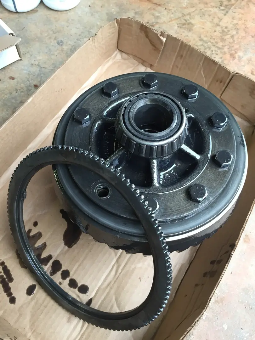

Lockers, Lockers, Lockers... Or not....
Waiting on a new tone ring to show up. The lockers are in the carriers, but waiting to reinstall the carriers into the housing.

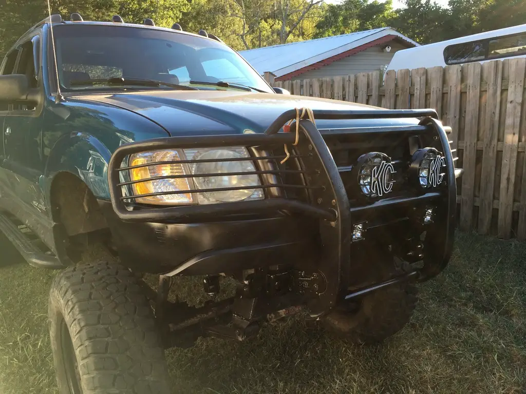

Long time without updates... Everything has been running pretty well. I replaced the front axle shafts with chromo shafts and HD U-joints and haven't had any u-joint issues since then thankfully. After a couple of my trips, I decided to chop the lower half of my bumper cover and gain more approach angle. Basically I have been trying to do things that are free because what I really want to do will be quite expensive and other hobbies are getting in the way of the truck fund.
