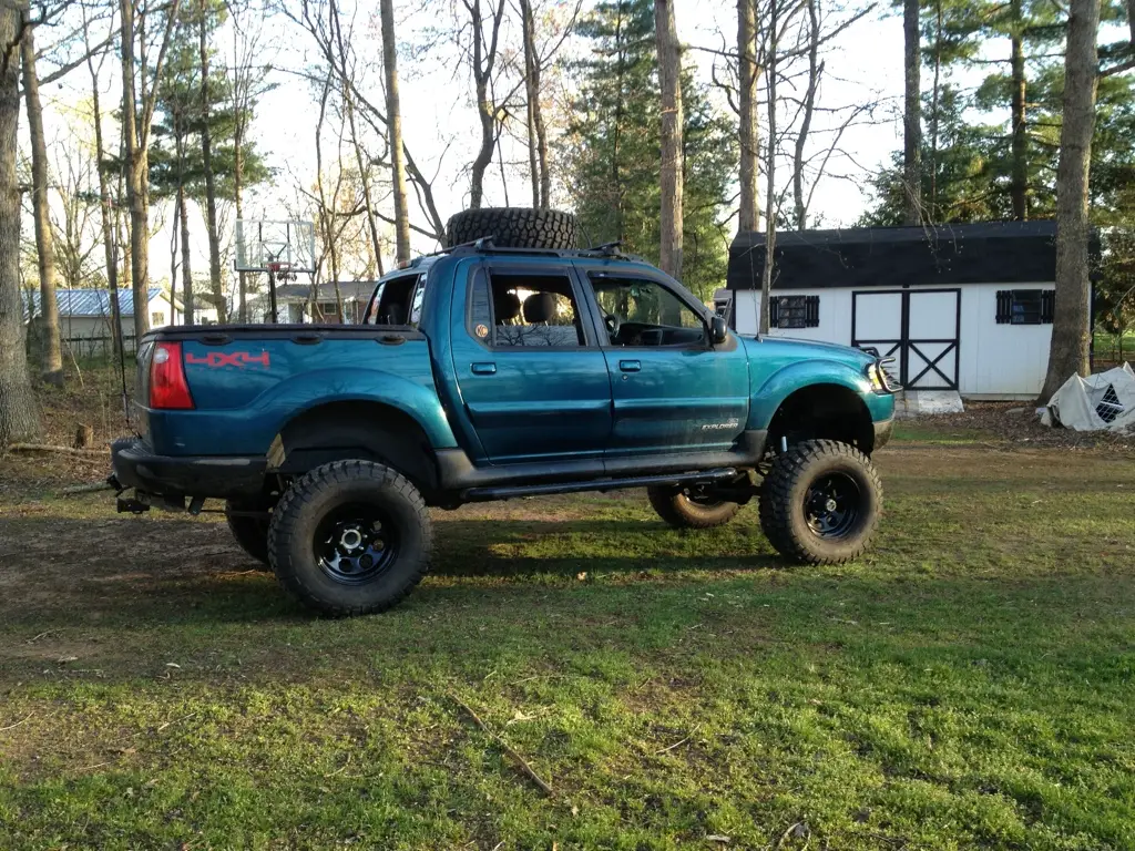

A little planning and 4 months later, my Sport Trac finally has a solid axle in the front.
Current Look:
Front Axle

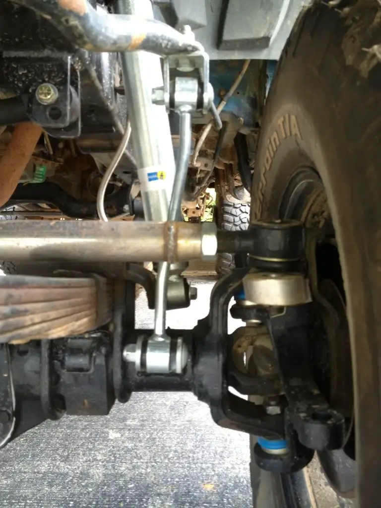

- Low Pinion Dana 44 from a 1988 Grand Wagoneer
- 6x5.5 bolt pattern
- 4.88 gears (still open diff for now)
- Superwinch manual hubs
- Disc brakes
- Custom spindles tapped for hi-steer
- Custom 1.5"x.25" wall DOM drag link and tie rod
- Stock Grand Wagoneer 7leaf pack flipped to SOA
- Bilstein 5100 shocks (originally for Jeep JK with 6" lift)
- Ford Super Duty steering box (pre-drilled for hydro-assist in the future)
- Drop pitman arm for Super Duty with 4" lift
- Front stainless brake lines for stock Jeep TJ
- Custom sway bar end links
- New Moog ball joints and bushings
- Grand Wagoneer track bar mounted to frame rail

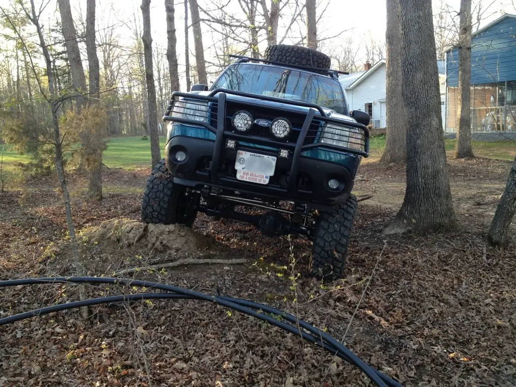

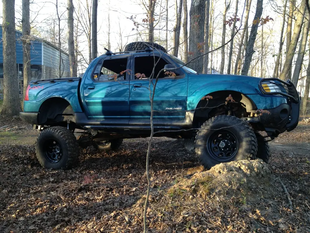

I havent really had time since I got it back due to work and school to test it out off road more than the 15 min that I drove it around my yard. Here's some pictures with the track bar and front sway bar connected (and it wont flex at all with either of those). The rear flexes even more than it did with the SUA and just TT/shackles & body lift. I found out that my rear driveshaft just barely scrapes on the lip of the gas tank skid plate. That will be easy to fix as there is plenty of room to curl the edge up a little.
