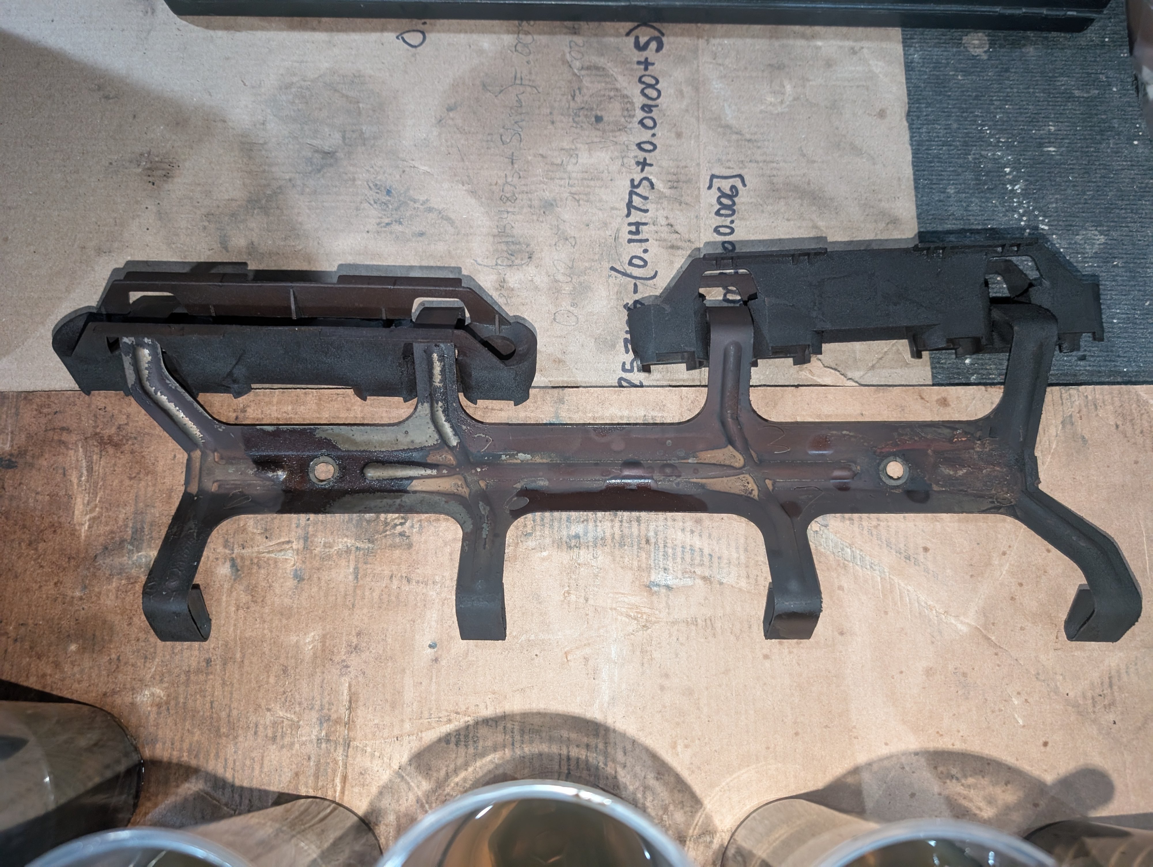

What do I need to know about getting the lifters out? I thought they just lifted out but these do not want to let go.
Did you remove the spider and guides?
Spider...I get it haha. Yes, I did.
I drizzled some ATF over them too to try to break up any varnish, but it hasn't helped.
