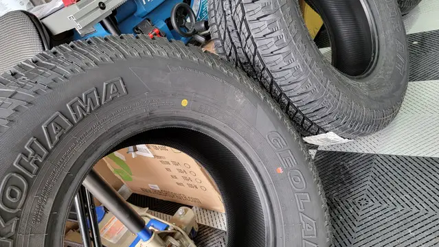

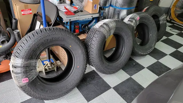

Tires showed up.. I hope they fit, LOLLLL... Ended up going with some Yokohama's which seemed like they rated and reviewed pretty decent.. not to loud and a nice blend of mostly on-road driving with some light offroad capability and bad weather:
Ended up goign with 275/70R16 which is only a tad larger than the tires already on the truck which are P255/70R16 and the size a few people in a tire thread on here mentioning fitting without any issues. Comparing the 2 sizes:
Current:
255/70R16
Diameter : 30.1"
Width : 10.0"
Wheel : 16" x 6.5-8.5"
(LT Tires 6.5-8")
Sidewall : 7.0"
Circum. : 94.4"
Revs/Mile : 671
New:
275/70R16
Diameter : 31.2"
Width : 10.8"
Wheel : 16" x 7-9"
(LT Tires 7-8.5")
Sidewall : 7.6"
Circum. : 97.8"
Revs/Mile : 648
So... around 1.1" more diameter, 0.8" wider, 0.6" more sidewall, 3.4" more circumference.
They were pretty cheap and I got a rebate on top. I seem to have a ton of room under the wheel wells but if I need to I can raise the front some and trim some of the liner if I need to as they are pretty tore up already in a few places, lol.
