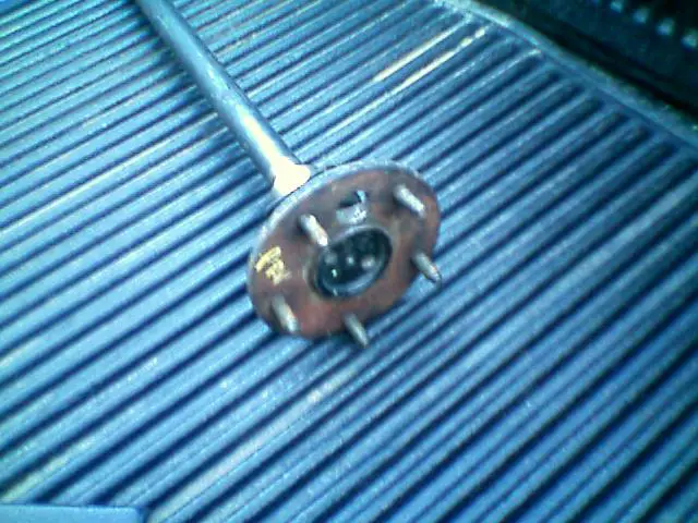

I just scored a 9" shaft that was staring at me at the junkyard sitting in the bed of a pickup the other day. It's a 5x5.5 plus it has the hole for accessing the nuts holding it in place.
While staring at this I was wondering if one could weld in plugs to fill in the exisitng lug stud holes and then re-drill for the correct bolt patter.
Due to the location of the hole I cannot just space and re-drill. Since we are discusing this, I will ask it here vs. start a new thread.

Unfortunately I dont think rewelding and redrilling will work cauz of the heat problem which might lead to stress areas. You could get the whole thing hot with acetylene but then you might start warping the flange unless you had good control of the heat or a furnace. Also, I think redrilling a weld will be very difficult as most filler metals are a little difficult to machine. But these are just speculations since I've never modified an axle shaft's flange ( = I are a total newb on this).
The stock rear axle shafts can't be redrilled for 6 on 5.5. You have to get alloy axleshafts. If I remember right that is what Spas did. Maybe you can ask her. If that doesn't work then you can convert the front to 5 on 5.5
