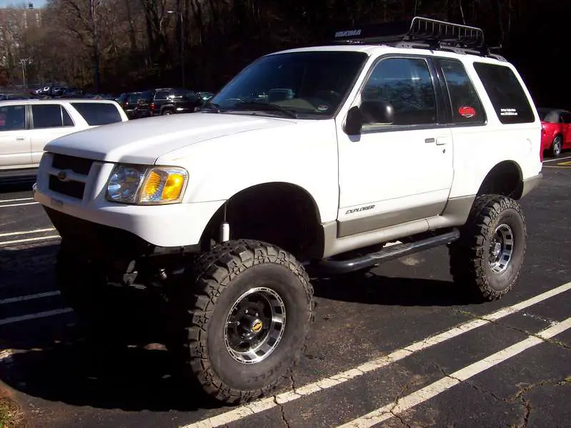

nice..thinkin im gonna just stick with 7-8" of suspension lift..never did care much about body lifts tho..those 36 or 37's??
^^They're 37s. We'll make sure we have the forklift out this weekend and we'll flex that thing out. We're gonna try and setup our bender tomorrow too, so those nerf bars will have to go soon in favor of some sliders. :D BTW, remind me to tell you about our grand opening party. We need to see if you can come back in town for our car show we're having that weekend.
ok ill remind you bryan, DMAN i disagree with everything you say, i like all the lift, i love the skid plate, and i like the curve of my front grills/plastic, now if you want to send me over some money so i can have a nice front bumper made, be my guest, but thanks for all the negativity frickin mall crawler
Not a fan of the skid either. Bend him up a fawkin' bumper while you got the bender out.

yeah thanks rock ranger, and for you skid plate bashers are you claiming it would look better as it was before like this?
Yep, looks fine.

yeah alex rolled it like in the summer, so a long time ago it was only 2wd, and j602 how can you claim an exposed radiator and hoses look better than a skid plate?
From the angle that shot was taken in the front wheel well just doesnt look right, Its like someone put a sport on the wrong wheel based frame :p:

so how much lift did it end up with? how does it steer/handle on the road? what mods are done to the steering? thats the sweetest 3rd gen sport i ever did see
Roughly 10" suspension, 3" body. It's got Waggy steering on it. VERY far forward steering box with drop pitman arm reamed for Waggy steering. Also has a track bar since the draglink is at a decent angle. It's got a really tight feeling steering and it feels pretty top heavy at times, but that will be extremely lessened when he gets his new tires and wheels. (Lot less backspacing)

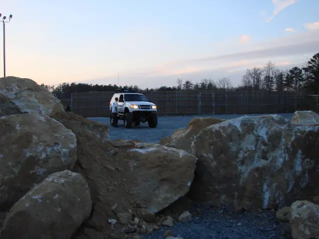

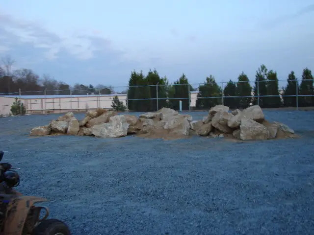

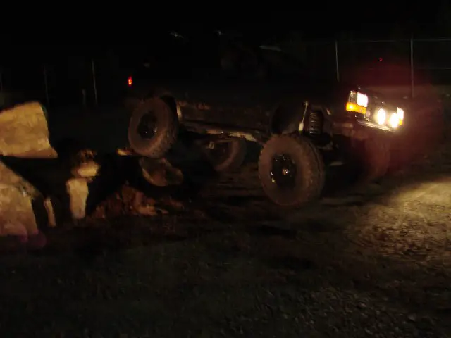

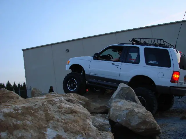

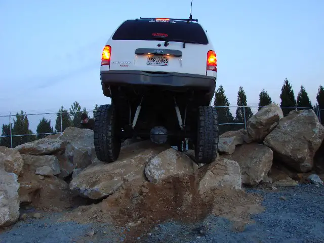

Here's some pics of Robbie on the rock garden. When he came over, they'd just gotten off the dump truck, so we didn't have time to arrange them at all and this was really the only passable place for him. Since these pics, we've moved all the rocks into better locations.
