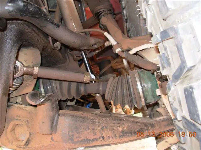

A week ago I would have told you to go with the Dixon Bros "upgraded" tie rod setup, but CG broke his brand new TRE running Golden Spike on Saturday.
I'd say keep the stock setup and carry a trail spare inner. I only had to replace the inners once before I yanked the R&P for the SAS. . . so less than once a year, and they aren't hard to replace.

Was it bent/broken along the body or at the ball joint? I agree that the tie rods do look a little weak along the body and I recall seeing some images of bent tie rods - maybe sleeving it with pipe or tube would help prevent it from bending/breaking - just a thought.

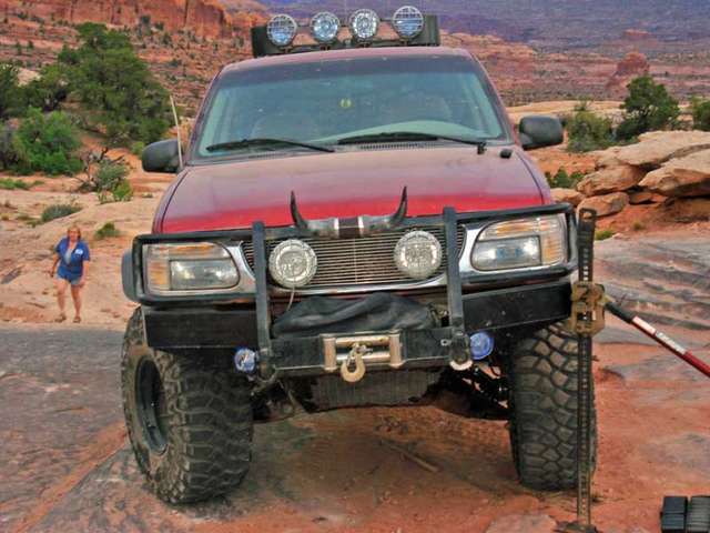

BTW are those Krawlers? CG must be oozing $$ :D
Jefe said:
I think those are Truxxes. Not Krawlers though
Oh really? Sure fooled me!! (the wave and the square profile)
CG runs Maxxis Creepy Crawlers. (the Other crawler) ;)
also $$ :D
Anybody remember that movie called Excalibur? There is a scene in it when King Arthur is fighting Lancelot & breaks the sword Excalibur. He looks at Merlin & says “Merlin, what have I done” & Merlin says “You have broken, that which could not be broken”
I was reminded of that when I broke that outer tie rod, I was pretty amazed! To be fair to Aaron Dixon though, his clevis system is made to work with his long travel A-Arm front end. To get it to work with the stock length arms he needed to put a 5 degree bend in the outer tie rod. I think what he did was put the ball joint end in a vice, then thread a tube on the other end and pull it to where it needed to be. That is what I think weakened the threaded area.
I bought a bunch of outer links & I’m going to experiment with bending them the 5 degrees by sliding a larger tube over the threads & pulling that…just need to figure out how not to ruin the threads.
I’m pretty sure it cracked/bent going through Golden Crack, that was the first time I felt a lot of binding pressure on the steering & just fought it & kept going. Usually when I feel that binding I back off a bit to ease it & go forward again.
I think Jefe’s idea of keeping some replacement stock ones is a good idea, they are pretty easy to change (even if you don’t know how to line everything up again like me :rolleyes: ) Where the Dixon/Camburg one is going to help a lot is if you like running fast through rocky terrain, once you start banging them off rocks with 35” tires, you’ll bend them pretty quick.
“BTW are those Krawlers? CG must be oozing $$ ”
Mostly I ooze Bull Sh*T, but that's another story ;) My tires are Maxxis Creepy Crawlers, a great tire for about $100.00 less each than the Krawlers… Speaking of tires…Colin do you still hate the Xterrains? They seemed to pull you over everything out there last weekend…
Sorry for the hi-jack, but I did see a picture of my sexy truck in here so I thought it was OK :D
