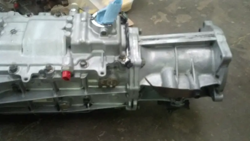

SWEET BEANS!! I picked up an M5OD-R1 for $175 the other day! Naturally its COATED in oil from the engine, but It should clean up nice. I have to replace the rear main seal, so I'll pick up a t-case, rear DS, clutch kit, slave cylinder, and flywheel next week so I can get that leak taken care of. :D
Tranny: $175
T-case: $75
D-shaft: $40
I'm gonna pick up the rest of the parts tomorrow and hopefully have the rear main seal replaced and the 4x4 tranny in next weekend

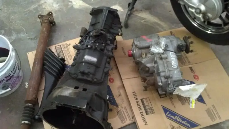

cleaned up the tranny and bought a few more parts:

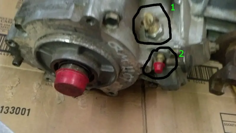

HELP!! What are these connections?

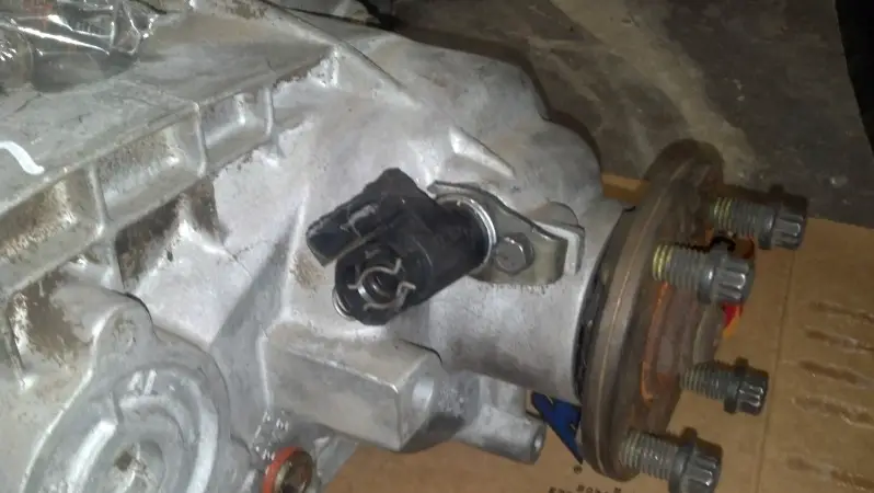

And do I have to do anything to plug the speed sensor?

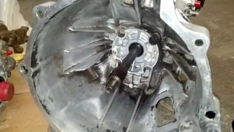

one more silly question: how much end play should there be on the tranny input shaft? there seems to be quite a bit, but no play at all on the output shaft.
I'll keep doing my research... :frospecta
from what I can tell, radial play on the input shaft isn't a big deal as long as there is no excess wear on the shaft and no lateral play. I'll double check the 2WD tranny when I pull it for further confirmation. can anyone tell me if I'm correct?

Make sure you plug the speedo gear hole, it will leak. I just chopped up the plug that's there and gooped on some RTV but it does weep a little. A solid plug would be preferable.
@DAMARBLE if your talking about myself, I've been planning it because I couldn't sell my vehicle for much with the miles on it, but i know what the engine is and the reliability of my particular engine and condition, i'm going to go with the manual hubs and http://theshiftster.com/ instead of shift motor, gunna buy two, one to use and one to rig up so i can use it without having to get out. And i also like to do things just to say i done it. On the speedo gear hole, where exactly are you talking about? on the t-case itself?
That's correct as the pilot bearing in the flywheel will support the shaft.
