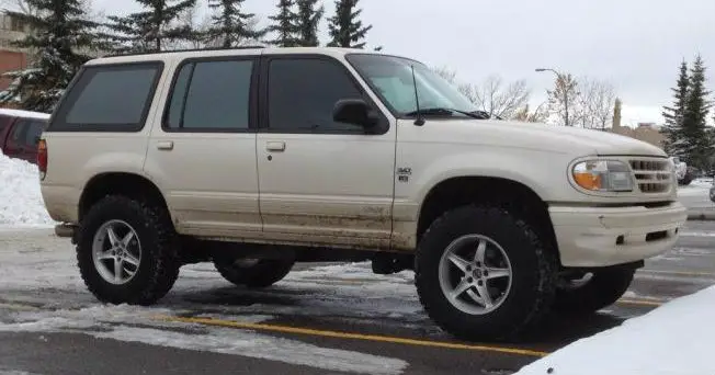

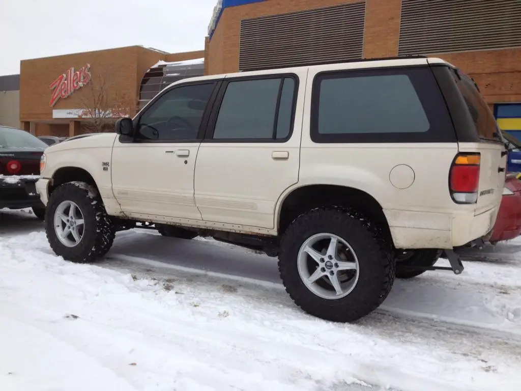

Tires are on
Got the new tires on. 285/70R17 Goodyear Duratracs. Looks really good. I needed 1.25" wheel spacers to clear UCA and swaybar with these wheels. I also need to trim the running boards and put them back on. Would be nice to clean it but the weather took a turn obviously.
CDW6212R
Hauls the mail.
June 17, 2004
19,825
1,212
Knoxville, TN
98 Limited AWD
That looks great, it's a fine fit, size of tire.

that does look good. wasnt sure what it would look like lifted, but daddy likes! oh, btw. was watching the stampeders game on sunday. sorry couldnt help but laugh at the dumping you guys got! lol

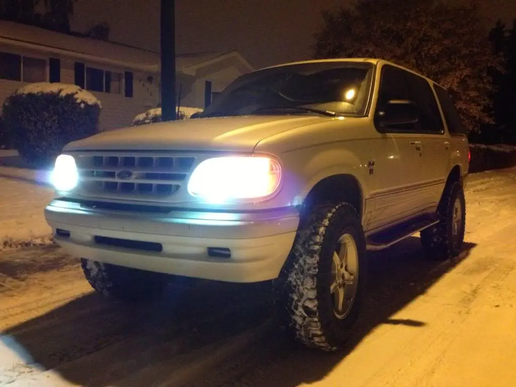

Hasn't warmed up enough to clean the truck. Re-installed the side steps and I did do some trimming to the "tupperware" as people like to say. Also installed the new front splash shields that were a part of the performance accessory gap gaurd kit. Left them off so the guys doing the alignment at the tire shop had easy access to the UCA's.
Night shots.

Very nice man! I love seeing pictures of Explorers in the snow, even if it is just a road, haha :D
Gotta say, I really have respect for how much work you put into this, and not even just the engine. Awesome job.

Looking good!! I like the look of the cobra wheels with the larger tires.

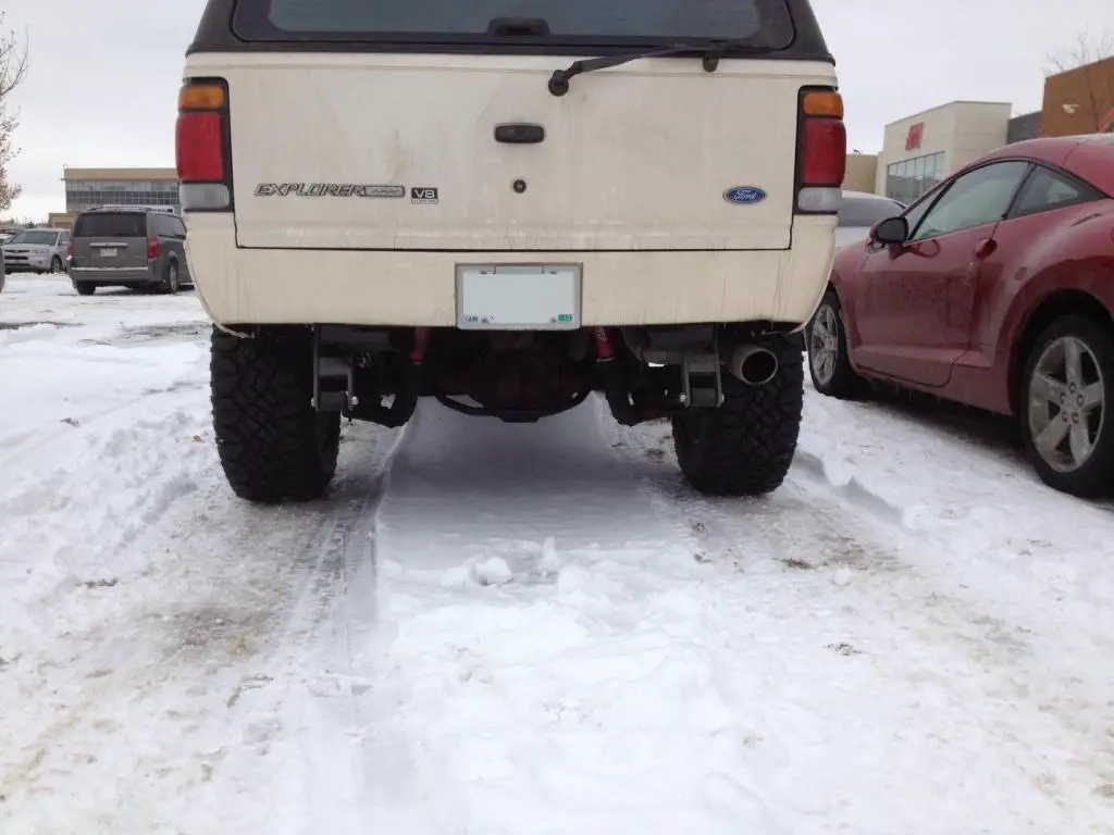

shocks and diff cover
|Shocks are shot, i'm pretty certain. I think the lift is having an effect on the Edelbrock shocks. So I went on a search of lift shocks for the exploder and came up with these RS5000 for 0" to +2" of lift. I don't care for the white shock look and then rusted white shock look so I scuffed and spray them something better. Also to improve on the looks and stiffness of the rear I picked up Monroe 5th shock and a cast aluminum trick flow rear diff cover to stay with the same theme under the hood. I like that it has the magnetic drain plug and cap girdles. This will improve the ratty and rusted factory diff cover.

Very nice, that'll look good from behind.
Yes I agree.
Before
After
Got everything in the back buttoned up. Need a bolt for the 5th shock lower bolt. The thing was worn down big time where the shock bushion is located. I know i've heard some say the 5th shock is useless, but it is definitely being worked if the bolt is worn down. With the shock bolted up there is about 1/4" of play. So glad i'm replacing it. The trick flow diff cover is a nice piece for the price. Comes with ARP 12 point SS fasteners, magnetic drain plug, fill plug, girdle bolts, and paper gasket (which I did not use, went with just black RTV sealant instead).
Observation, I had the Edelbrock IAS shocks for about 3 years and they already timed out. The physical size of the Rancho rod is 5/8" shaft vs. the Edelbrock at 1/2" diameter is noticeable.

nice. amazing how a rusty old diff cover can make everything look so bad. i know with the girdle i have, you can see it, even being lowered, and the pan on, but yours is lifted now, so it will slap you in the face if it looks like poop! good choice!
