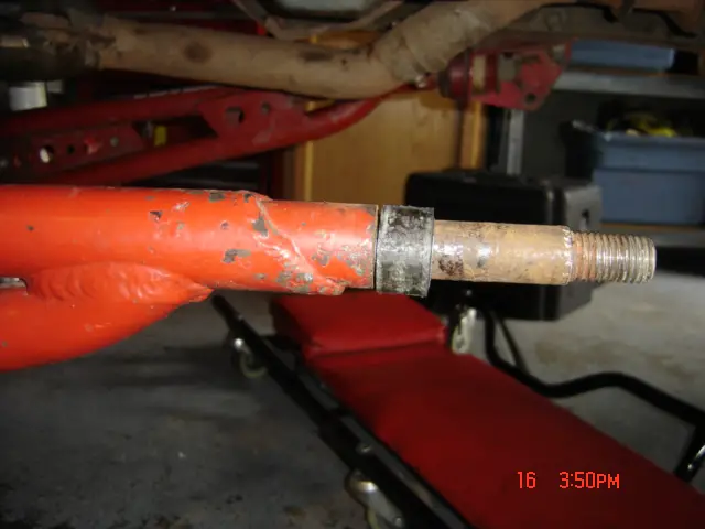

You can see where my driveshaft was hitting the body x member (top right of pic) NOT GOOD
Made a HORRIBLE bang a couple of times on the highway to/from Moab 07.... yikes
I had clearance when I did the 5.0L conversion, I lost that clearance when I went to the Duff urethane body mounts
Maybe I need a 0.5" body lift? LOL
